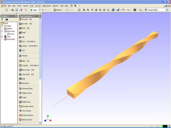

Lazer Posted August 16, 2007 Posted August 16, 2007 Twisted flat bar can be done by using the LOFT command, draw the rectangle (bar) then offset workplanes the distance you want and project the geometry and rotate it, keep rotating through the offsetted planes, then Loft. Quote
Aardvark Posted August 16, 2007 Posted August 16, 2007 Just draw the profile that you wish to "twist" (be sure to constrain your sketch centered around the origin point to make things simpler later), then select the "Coil" tool input the number of complete twists into the revolution box and then input the total length of the part divided by the number of revolutions into the pitch box. If you centered the sketch on the origin point you can use one of the origin axes to coil around rather than placing a work axis. Quote

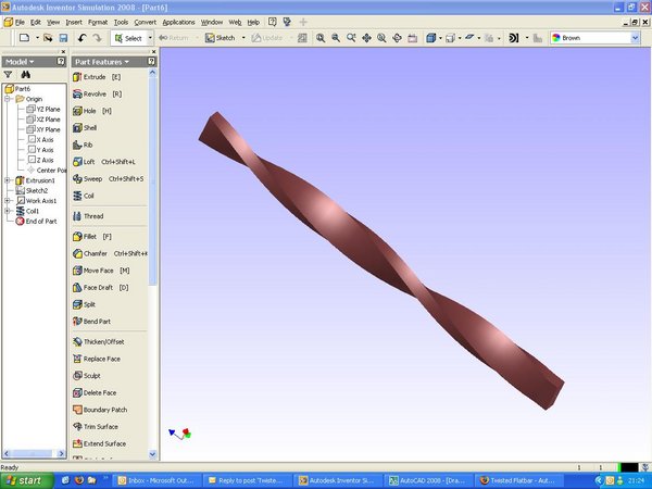

Lazer Posted August 16, 2007 Posted August 16, 2007 To show I'm a good sport here is a pic of the coil way (take note of the browser on the left) Quote
Lazer Posted August 16, 2007 Posted August 16, 2007 Loft works well when you want to twist between solids with lets say a gap, that way by offset lofting it will give an accurate profile from A(start) to B(finish), have a play and see the difference:) Both ways work, all depends on what your wanting in the end result. Quote

vinod Posted August 18, 2007 Author Posted August 18, 2007 I got it correctly.. I saw extrusion feature in the image (#6).. What is the diff with post #10. I think extrusion is the base feature.. Am I r8 ? Quote
Lazer Posted August 18, 2007 Posted August 18, 2007 The first pic has an extrusion because I was going to as a flat first then twist, the second picture shows no extrusion I just drew rectangle with an axis throu it and coiled it. you don't neet to extrude. My model it is in Inventor 2008 so you won't be able to open it in 11, but that don't matter now, clad you got there in the end:) Quote
