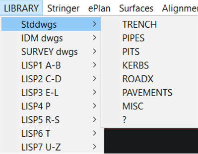

BIGAL Posted May 13 Share Posted May 13 Making a menu is very easy just use notepad and use menuload to do just that, I have been making menu's for like 40 years so go down that route all the time. The menu option is a button pick from a menu PITS, it then opens a Image section in the mnu file. Yes free block manager, using above, to explain more you need to make a slide of each block that is a captured snapshot of say your blocks. You can script this I have done like a 100 in one go. Once you make say 1 image section you can add more. I have like 30 image sections in a menu. The simplest way to understand is for you to make say 5 slides of same type block plus 5 of another same type blocks eg PITS & KERBS, just have block on screen and type "mslide" zip them up and post here I will make you a menu, you can then add lots more to it. In the menu you can do set layer then insert. Quote Link to comment Share on other sites More sharing options...
