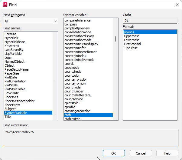

pmadhwal7 Posted May 6 Share Posted May 6 Hi supposed my dwg has 100 layout sheets and I want to put the layout number in each layout how it was possible in an automatic way, sample attached Layout.dwg Quote Link to comment Share on other sites More sharing options...
ronjonp Posted May 6 Share Posted May 6 (edited) Use a FIELD: %<\AcVar ctab>% Layout.dwg Edited May 6 by ronjonp 1 Quote Link to comment Share on other sites More sharing options...
pmadhwal7 Posted May 7 Author Share Posted May 7 9 hours ago, ronjonp said: Use a FIELD: %<\AcVar ctab>% Layout.dwg 97.6 kB · 0 downloads actually, i want those text inside the layout sheet 1 Quote Link to comment Share on other sites More sharing options...
mhupp Posted May 7 Share Posted May 7 12 minutes ago, pmadhwal7 said: actually, i want those text inside the layout sheet So create a text with that field inside the layout sheet. if its not a block you can use this to copy to the rest of the tabs https://cadtips.cadalyst.com/2d-operations/copy-all-layouts 1 Quote Link to comment Share on other sites More sharing options...
Steven P Posted May 7 Share Posted May 7 (edited) By LISP: (layoutlist) will give you a list of layout names (command "layout" "r" (nth x (layoutlist)) "-NEWNAME-") will rename layouts, here layout number x Make a loop the length of your layout list, and rename accordingly. If you need to grab the layout name from say, a block in each layout, this will take you to layout 'x' (setvar "ctab" (nth x (layoutlist))) wuill take you to the nth layout in your drawing Just need to put is all together, ask if you get stuck but that is the basics Or go here: https://forums.autodesk.com/t5/autocad-forum/lisp-routine-to-rename-all-the-layouts/td-p/3511636 EDIT Whoops got this the wrong way round, that was renaming sheets not a adding the sheet name into the drawing Use the (setvar... part to loop through the sheets, use (nth x (layoutlist)) to get the layout name and then edit the text as you want in the sheet from there, noticing that your sheet name isn't a field but is text? Edited May 7 by Steven P 1 Quote Link to comment Share on other sites More sharing options...
tombu Posted May 7 Share Posted May 7 Check out Lee Mac's lisp Layout Field http://lee-mac.com/layoutfield.html 1 Quote Link to comment Share on other sites More sharing options...

ronjonp Posted May 9 Share Posted May 9 On 5/6/2022 at 9:58 PM, pmadhwal7 said: actually, i want those text inside the layout sheet You should learn how to use blocks with attributes for your titleblocks. Then put that field in one attribute ( or make it the default value ) and all your sheets will automagically number themselves. Code is not needed for this simple task. 1 Quote Link to comment Share on other sites More sharing options...
