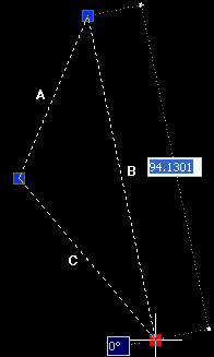

CC7125 Posted August 16, 2007 Posted August 16, 2007 Pardon my terminology, as I'm only a day into drafting and the like. Alright, I'm stumped. What seemed to me as a problem that should be simply solved; I've instead hit a brick wall. I'm sure I've missed something obvious. Anyway: What I want is a triangle with the following: Side A: 50 units B: 94.8 units C: 60.25 units The problem is that when I go to adjust the length of one side (B) (via the route in the diagram), it will readjust the length of side C; and vice-versa when adjusting side C. Is there possibly a way I can "lock in" the length, so it will hold? Is there any other way that I've missed in the countless tutorials I've gone through? Any and all help is greatly appreciated. Quote
ReMark Posted August 16, 2007 Posted August 16, 2007 What command(s) are you using to modify the line? Quote
CC7125 Posted August 16, 2007 Author Posted August 16, 2007 STRETCH - I'm using grip edit, and the dynamic input. Quote
ReMark Posted August 16, 2007 Posted August 16, 2007 I thought so. I don't think you can "lock" the length of the line(s). You could put two of the three lines on a different layer and then "lock" that layer. Would that do? Quote
eldon Posted August 16, 2007 Posted August 16, 2007 I can't imagine a more clumsy way to form a triangle of known side lengths. If you want a sure fire way of "locking" the lengths, draw a circle with a radius of the side. By drawing the circle from the upper point of line A of radius 94.8 units, and a circle from the lower point of line A of radius 60.25 units, you can then STRETCH the apex to the intersection of the circles Quote

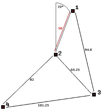

CC7125 Posted August 16, 2007 Author Posted August 16, 2007 I don't think so. If I were to lock it, it would need to just lock the length. I need the angles to be able to change and the sides of the triangle to not lengthen/shorten when adjusting an adjacent side. Basically, I just want a triangle with the dimensions I gave in my first post. If there's another way to do it, I'm all ears (eyes?). If it's of any help, here's a diagram of what I'm trying to plot out, to give a better idea of what I'm trying to do. Points 1, 2, and 3 are what I'm working on currently. The only information I have to plot it out is distances between points, so triangles seemed logical. Apologies if this is getting a too off-topic from my original post. Quote
CC7125 Posted August 16, 2007 Author Posted August 16, 2007 I'll give that a shot eldon. Thank you. That should do the trick. Quote

CC7125 Posted February 5, 2009 Author Posted February 5, 2009 My apologies eldon's suggestion did the trick for me. I had been expecting things to work a little differently than they do. I was thinking more along the lines of Computer-Automated-Drafting/Design, instead of Computer-Aided. If you understand what I mean. Overthinking the problem, I guess. Again, sorry for not following up sooner. Quote
