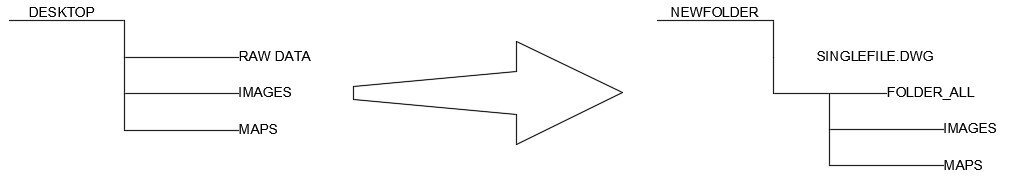

I'm trying to organize my workflow; I find myself using e-stransmit multiple times every day and would like to use a custom folder organization when adding my files to the final .zip file. Let' say I work in a .dwg file in a folder on my desktop and referencing files in that drawing from other folders that are located on Desktop (could be located in any other position, as well). When I'm done I wanna save the .dwg file with any references in a .zip file that will be e-mailed later. What I'm asking is a specific .zip folder tree: I want every reference to be a in a folder named "FOLDER_ALL" or whatever and the .dwg file to be in the same level as the folder but on its own. I'm attaching a simple chart to help you understand what I mean.
Ι've done some googling and even posted at autodesk forums but the answer I got was that it cannot be done through standard transmit, and maybe an addo-on is needed. I have some experience writing AutoLISP programs and would like some guidance to possibly implement what I'm asking for [I'm not sure it's achievable though].

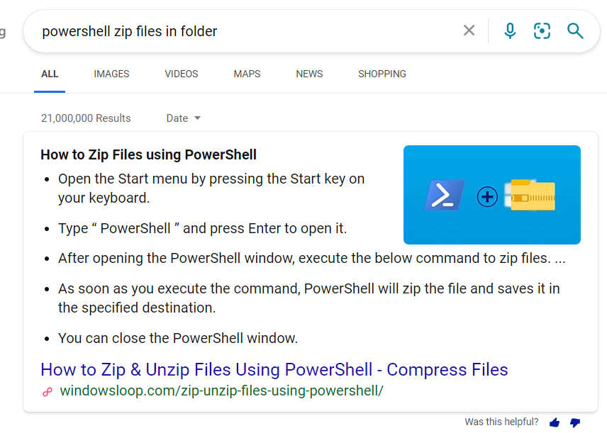

There is ways of doing ZIP possibly via Autocad I use a shell command to UNZIP files, I am sure ZIP Files would be similar.
(startapp (strcat "powershell -command Expand-Archive -Path '" filename "' -DestinationPath 'C:/GTA-CAD-TOOLS'"))
Ok 2nd step is that you can call email from Autocad not something I do. Need to google.
Had a play, ok a couple of things note the ' it is used to enclose names with spaces in them so have shown destination that way also, use \\ for path. The * is a variable to do subdirectories not a file wild card.
(setq directory "'D:\\your directory\*'") ; do some form of get path etc
(startapp (strcat "powershell -command Compress-Archive -Path  " directory "  -DestinationPath 'D:\\Acadtemp\\archive.zip'"))
How to Zip (and Unzip) Files Using PowerShell (howtogeek.com)
