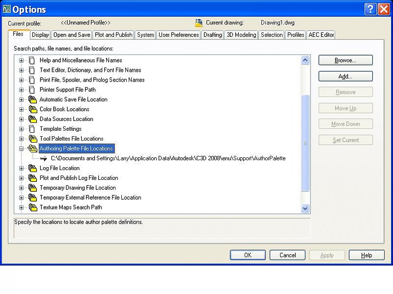

Go to Options > Files > Authoring Palettes Files Location; is there any files in the specified folder? I have 3 .atc files- Parameters, Actions and Parameter sets
In that location I have only AcTPCataloug.atc, not the fiels you have.
In the same folder isn't there a sub-folder named Palettes with the 3 .atc files? If not, I think that may be your problem. I'd do a search on your computer for all .atc files to try and find them.
They are not in that folder, nor can I find them.
I wonder what happened to them. Have you tried a repair of the installation? If that doesn't work I'll post mine in a zip file if there isn't a copyright on them.
