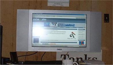

I keep goin' larger, larger, larger. Presently usin' a 36" LCD/TV, DVI input from the PC's video card, 512 mb onboard memory.
Picture by picture, picture by picture, cable TV input.
Always a pleasure to use, easy on the eyes. :roll:
Wall mounted, tilt 'n swivel, saves real estate on the desktop.
