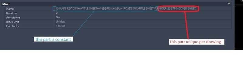

Hi All,
Apologies if this has been solved before but I have searched for hours and counting but to no success.
I currently a title block in multiple cad files that needs to be renamed. This title block is exported from REVIT so it has unique names on it as shown in the attachment.
There are parts of the block name that are consistent throughout the cad files so I suspect a wildcard search is needed. I just don't know how to do it.
Is there any lisp that I can use to rename the title blocks using a wildcard search?
I want them renamed to "TITLE BLOCK 1"
Any help would be much appreciated

Hi Emmanuel, thanks for the reply. The title block does not have any attributes to it. All the attributes, ie title of the drawing, dates, drawing numbers are on a separate Block.
Yes I have thought of what you suggested but I was kinda hoping to have something automated as it will require me to open around 100 drawings per package.
