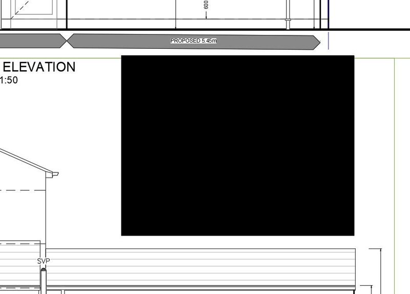

The only way to fix this is to select the table and change its layer to another one and then back to it's original layer.
Attached is the before and after drawing to test.
Before that lay trans command
After the fix I've described above

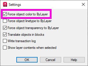

Found the issue with what setting was causing it
Table with Problemo After LAYTRANS.dwg Table with Problemo Before LAYTRANS.dwg
Edited by 3dwannab
Found exact cause
