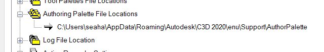

BIGAL Posted August 4, 2022 Posted August 4, 2022 I dont have Architectural but if you type CONFIG then FIles is there a pointer to the location of the fdc. Like this Maybe Quote

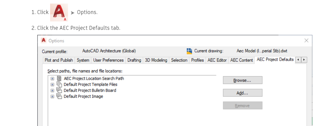

BIGAL Posted August 5, 2022 Posted August 5, 2022 (edited) Providing you have an object supporting an area a field will update automatically when you change a shape, using lisp to create the field formula. So many area -> field lisp. Did you check the Archi project defaults did that help ? Edited August 5, 2022 by BIGAL 1 Quote
