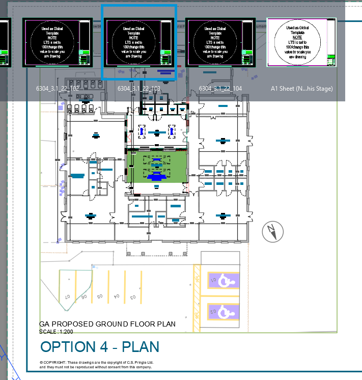

I have this variable FILETABPREVIEW set to 1.
But this is what's happening. The layout tabs preview is wrong. Perhaps there's a variable I'm missing here to update them.
The notice seems to be telling you to adjust the linetype scale. But I could be wrong.
That's just the original preview from the original dwt file. Sorry meant to say that in the original post.

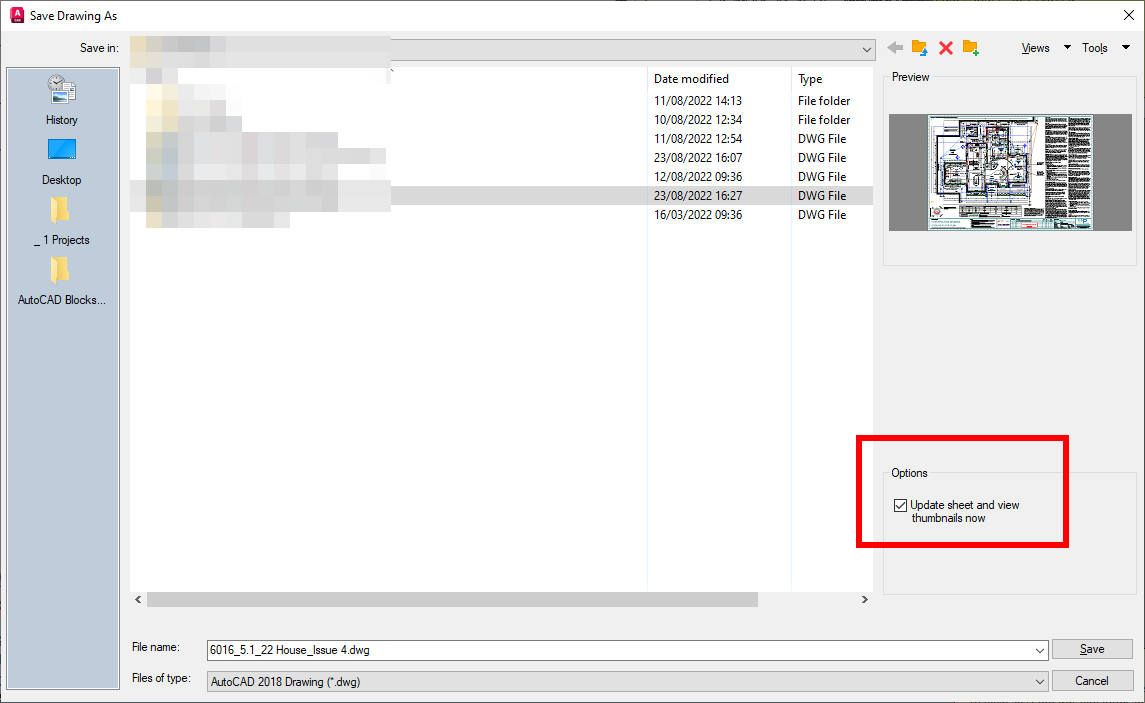

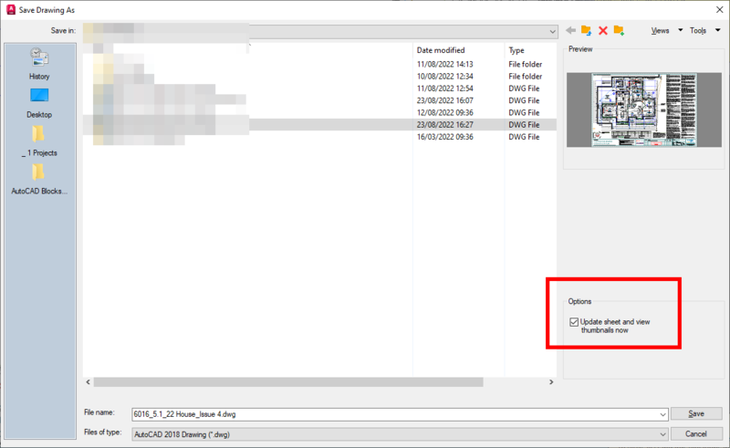

I set the UPDATETHUMBNAIL variable to 8 and it seems to work okay.
But doing this works better and more consistent I think as it forces it to update all views.
There's also the UPDATETHUMBSNOW command but it doesn't seem to update the model space.
