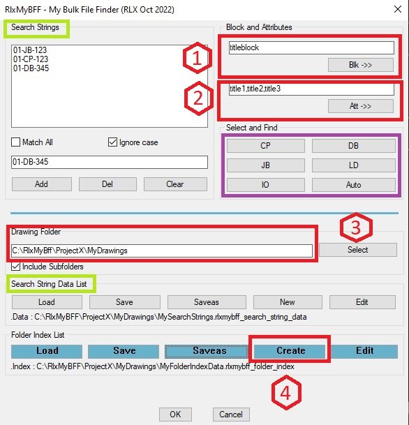

So I came up with the idea to first read all the titleblock titles in the project folder and save this to a (txt) file.
Then, having the loop open in AutoCad , I wanted to be able to either type in part of the title in the search list box or
select the JB or CP symbol and open the drawing.
And that's when I decided to create my very own BFF (Bulk File Finder)
App is still in its beta but so far it seems to be doing what I hoped it to do.
(but some little points may yet come to surface , but hey , baby is only one weekend old so gimme a break)
Make sure you put in (1) blockname of your (title)block , (2) name(s) of attributes with the titles in it,
separated by comma's , (3) select your drawing source folder and (4) choose create (don't forget to save it afterwards)
In the top left listbox (green) you can put in some search strings and you can also save this.
When all this is done and you press ok , it should find all the drawing (titles) matching the search criterea.
Some of the Select and Find buttons (purple section) are not working yet because those will involve some company special ops.
Most of my time went into the interface and progress bar thats activated when scanning for folders, drawings & titles.
Maybe it will be helpfull to others , maybe not because it might be too specific to my own situation but I present it
