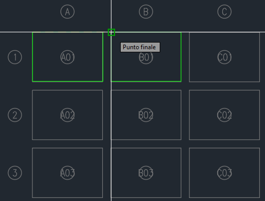

Hi, looking for a solution to automatically create layouts starting from a grid in model space I found the PlotDWGarr.vlx lisp (here: https://www.cadforum.cz/en/download.asp?fileID=1172).
I use the associated lisp LayDWGarr.
I also saw a tutorial on how it works (here: https://www.youtube.com/watch?v=nNiIVZvqXLk).
It seems to me that I have done everything correctly, the layout template (PlotArrTemplate), the succession of entry points etc. but the layouts that are generated always point only to box A01.
I doubt it's the lisp that's malfunctioning, but I don't understand what I could have done wrong.
What could be wrong with my file?
Do you know of an alternate lisp that performs the operation I am trying to do?
Thank you in advance

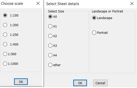

I have something but its not free but very cheap, it looks at the rectangs and makes a layout to match. It would need some custom changes to suit your needs as grids. The obvious 1st step is making the rectangs.
I have made 40+ layouts in one go.

I solved! obviously I was wrong ...
Simply the layout (PlotArrTemplate) must not have the view locked!
LayDWGarr works perfectly, highly recommended!
Now I have to look for a "layout manager", (rename ... navigate ...) if you have one to recommend thank you
How did I not think he didn't have a solution!
My faith in Lee Mac is still not strong enough!
Thanks!

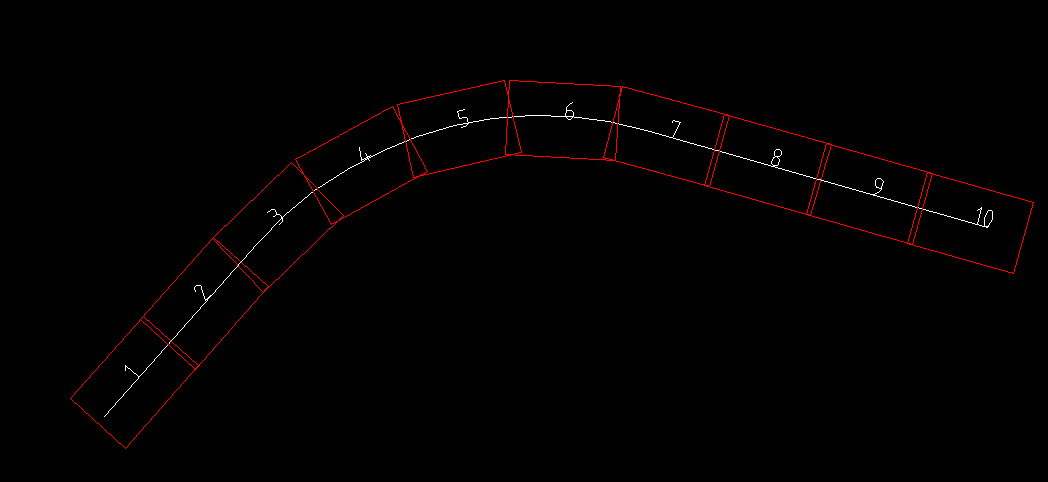

Just a comment I have 3 ways to make layouts matching rectangs, walk along a p/line, pick a point and make horizontal.
Rectangs can be rotated and that is reflected as a twisted view in a layout, viewport.
As I said real cheap as I normally have to customise for each end user, just posting code would mean repeated questions here while people try to get it to work. I normally include matching plot code as well for free.

Hi.
here is a lisp that deal with multiple rectangle frames including twisted frames and scaling the viewports.
1. the rectangels must be in "Layout_Frame" layer (hard coded to the code - can be change in the lisp) to make selecting the rectangle frames easier in big drawings with many polylines,therefore this layer must exist.
2. it can be only one viewport in the base layout that is used to copy in the lisp.
3. to control the scale, the rectangle frames must be at the same proportions as the base viewport this way:
     a. draw a rectangle on the viewport so they are both identical.
     b. make sure the rectangle is in "Layout_Frame" layer.
     c. copy that rectangle to model space - then it can be rotated and scaled as needed.
     d. scaling: for 1:5 scale the rectangle by 5, for 1:8 scale by 8, etc'
EDIT:
the rectangles must be drawn from left to right (upper left to bottom right or bottom left to upper right).
Any improvements and/or additions are welcome!!!
here are the code and sample drawing (use A-4 layout for test):
