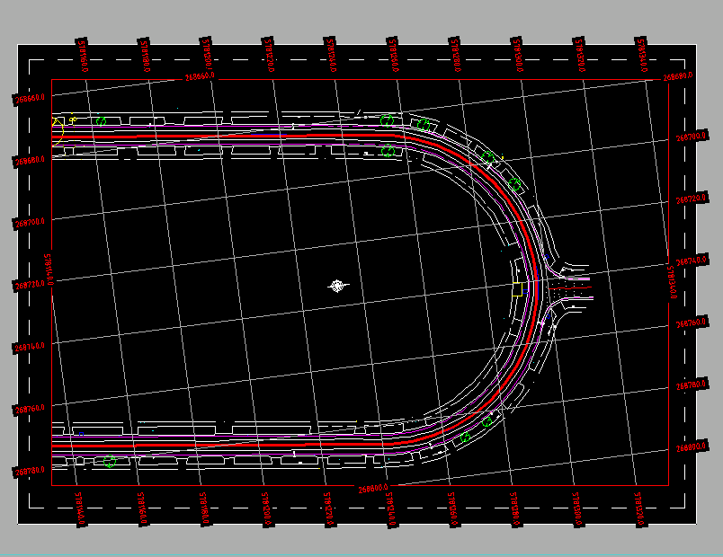

Maybe this. 20mm grids to and a twisted view. Not free but very cheap
Edited by BIGAL
