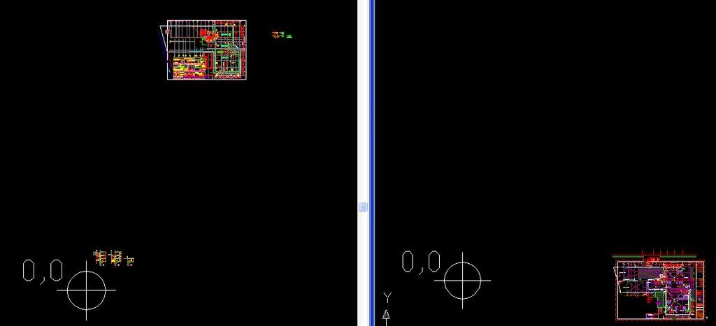

Can we change the 0,0 point of World UCS to another place in a drawing ?
I want to ajust some drawings with XREF and i want all the insertion points at the same 0,0 without moving all my drawing and by the way **** my viewport lol

yeah but the insertion point of Xrefs is always set to UCS world 0,0 point...
