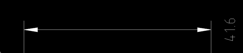

As usual I hope I can explain myself...lol
Can someone help with a routine so I can place a dimension at 90deg from 2 clicked points AND have it offset 17" from the second clicked point?1554410901_Newimage.thumb.jpg.3b3f232412786f36238ff1ba238155eb.jpg
Have a look at this little bit of code it makes a dim and then moves the dim text. Its 120 in mm the mapcar is X Y Z offsets.
(command "dim" "VER" p1 pt1 pt3 "" "exit")
(setq obj (vlax-ename->vla-object (entlast)))
(setq tpos (mapcar '+ (vlax-get obj 'TextPosition) (list 125.0 120.0 0.0)))
(vlax-put obj 'TextPosition tpos)

hmmm,
Is there a way to set the angle of the dimension text?
After thinking about what I actually need to get done, this could be just text using the distance between the two clicks.
Then find the angle and turn the text 90deg and offsetting a distance from the second click?
Ok found it adding to what I posted earlier, need angle in radians. The offset point may need the values worked out like 1/2 dim length. Not tested.
(command "dim" "ver" p4 pt1 pt3 "" "exit")
(vla-put-textrotation obj (/ pi 2.))
