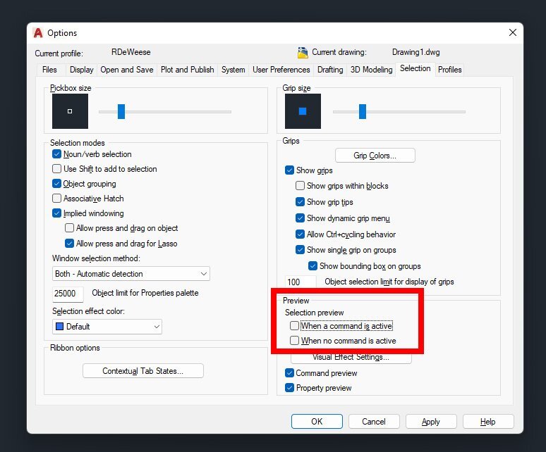

That's the same as SELECTIONPREVIEW 0, it only disables it when no drawing command is active, so the exact opposite off what I need.
When I have them both disabled, there's no highlighting during commands. I'm using Autocad 2018 though. Maybe it's different in Map 3D 2015.
