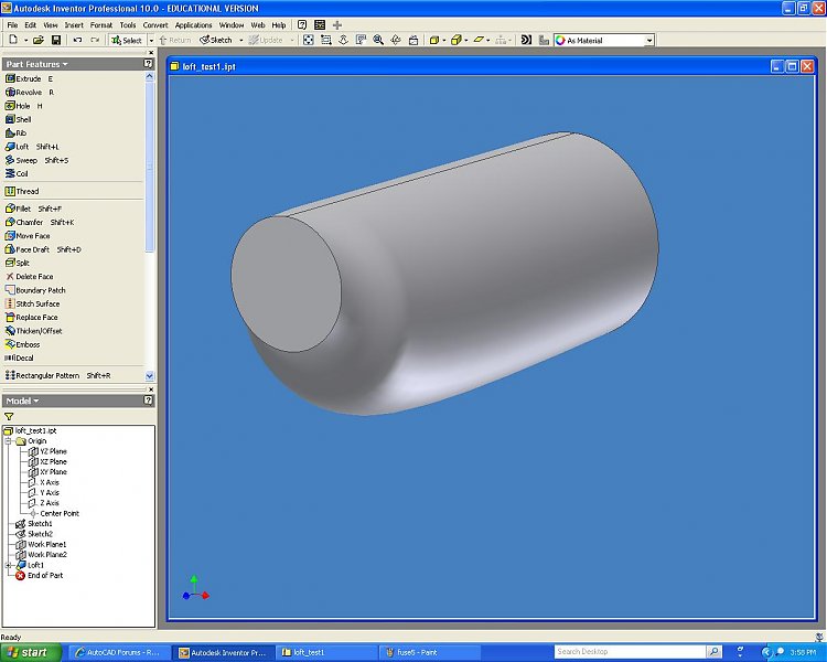

How can I fix this loft?
I'm self learning Inventor and I can't figure this one out. I showed a friend and he said I need more sections, which I'm not 100% understanding... the loft is like a spline and while more sections would constrict the splines more, they still wont be perfect.
Is there a good tutorial out there regarding the transition tab of the loft tool?

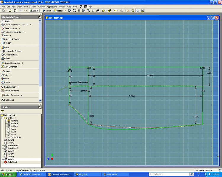

I'm trying to loft the following front of a model airplane. I want the loft to follow the red lines. The red arrows point to the spline part of the loft taht its off.

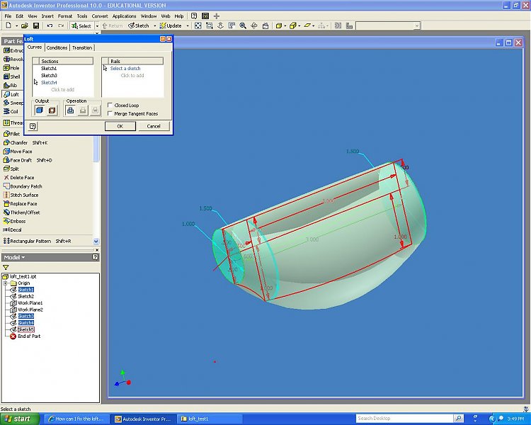

You forgot to zip and attach the file here. (pretty pictures aren't very useful)
I do not see any rails selected.

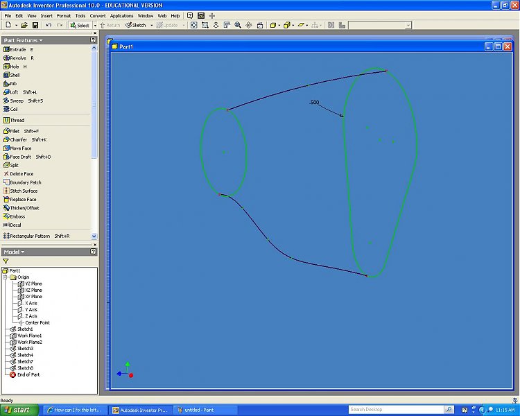

on the right side of your loft dialog box, if you click in the rails box where it says click to add, then select your red lines as rails you should be better off. There are certain conditions your rails need to meet in order to be used but it appears as though your rails go through your sketches so im thinking you might be okay.
if you dont want to use rails you can also check out the conditions and transitions tabs and set your loft at angles coming into and going out of your sections.

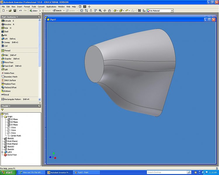

your sketches are a little "off" but i think you have the right idea. You can do 3 separate lofts and get the shape close without using rails, but to actually get the shape you will need to setup rails and they will need to have verticies on your fuselage profiles. right now your "guides" are close but they do not touch.
i did a few to show you.
As far as i know, jd will correct me if i am wrong. your rails each need to be their own sketch. Also your rails need to be coincident with your cross sections or they are not valid to be used as rails. I am not sure if you can have rails in inventor go through multiple cross sections but i will assume you can.
...your rails each need to be their own sketch. Also your rails need to be coincident with your cross sections or they are not valid to be used as rails. I am not sure if you can have rails in inventor go through multiple cross sections but i will assume you can.
You are correct on all counts (later versions do not require that rails be in different sketches, but if I recall v7 did have that limitation).

okay so here is your issue with the rails. Above we stated that you need rails to be on separate sketches for older version of inventor, and the projected geometry is going to need to be converted to a reference. You can see in the pic i attached that all the red lines are on a single sketch. what i did was edit your sketch 5. I left the top spline there but i changed all the other lines to construction lines.
Your bottom two lines will not work as rails. you need to redraw that for it to work. I redrew it and overlaid your line so you could see. the issue is that you have two separate lines for your bottom rail and there is a sharp corner between them.
Try using a different sketch plane for each rail(top and bottom) and make sure that whatever projected geometry you use that you select the construction button that (edit: jd posted a few posts up) to convert it to a construction line only.
