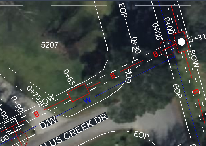

I want to put station marking for my job like the attached screenshot...I found a lisp code online which put station marking but its doing with interval which i don't want...i want to put station mark at my desired points...how can i modify? I have no idea...please help

Please Upload your sample.dwg
I have this.

(defun c:chainage&leader ( / js htx AcDoc Space ent perim_obj pt_ref dist_ref nw_pt dist_pt len_vtx pk)
  (vl-load-com)
  (princ "\nSelect a curve object where you want make a chainage.")
  (while
    (not
      (setq js
        (ssget "_+.:E:S"
          (list
            (cons -4 "<OR")

thanks for replying...its working but I want it to show like 88' = 0+88   145'= 1+45    1256'=12+56   it should calculate distance aligned way of that line,,,,and want to remove that leader
This task has been asked many times I would Google "label chainage autocad lisp" there should be one already done that is what you want.
With minor adjustments

wow...it works perfect...it is showing in inches calculation, how can i change this to feet. And will it take my own value as its for reference point instead of 0+00...that will be helpful....thank you so much
I am not familiar with this measurement system, I mainly work in metrics but I think that the modifications made to the last code posted will meet your expectations. You can also set the start other than 0+00 by default.
So reload the previous code...
