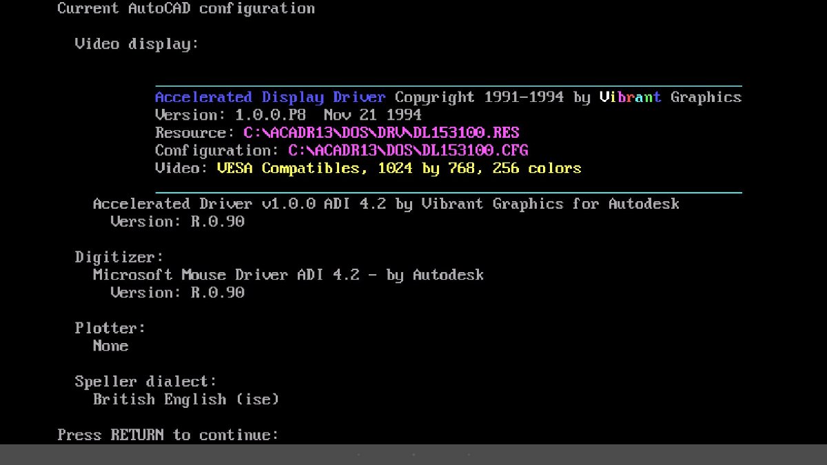

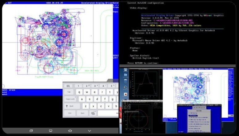

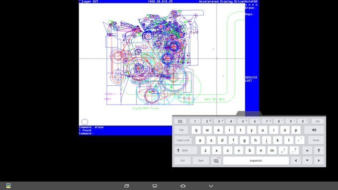

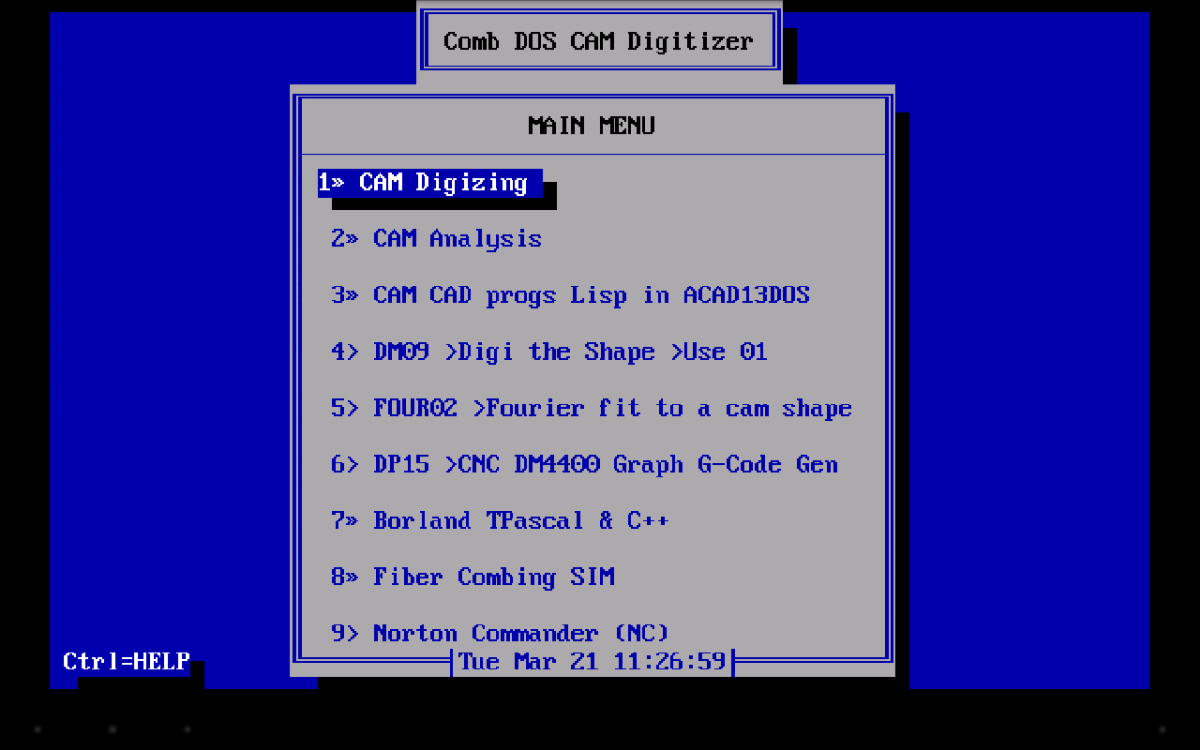

Help Needed to find a DRV 1991 CAD graphics driver files :
( last time asked : 5 Oct 2018 Twitter+LinkedIn, I live in hope )
This is an AutoCAD 13 from 1990 running as VM on 21" SAMSUNG Tablet, biggest ever made. It is my retro project to preserve my work I did for CSIRO in 1990's that lead to so much success for Dr.kirby and myself. So I am looking for an AutoCAD driver DRV file capable of displaying 1920x1024 or 1050 resolution. The DRV I am using is 1024x768 stretching this gives bad results. Accelerator needed is ADI 4.3 or 5.  This is only an issue for DOS version no such isse for Win as AutoCad uses windows drivers.
Thank you Guys
//Nick

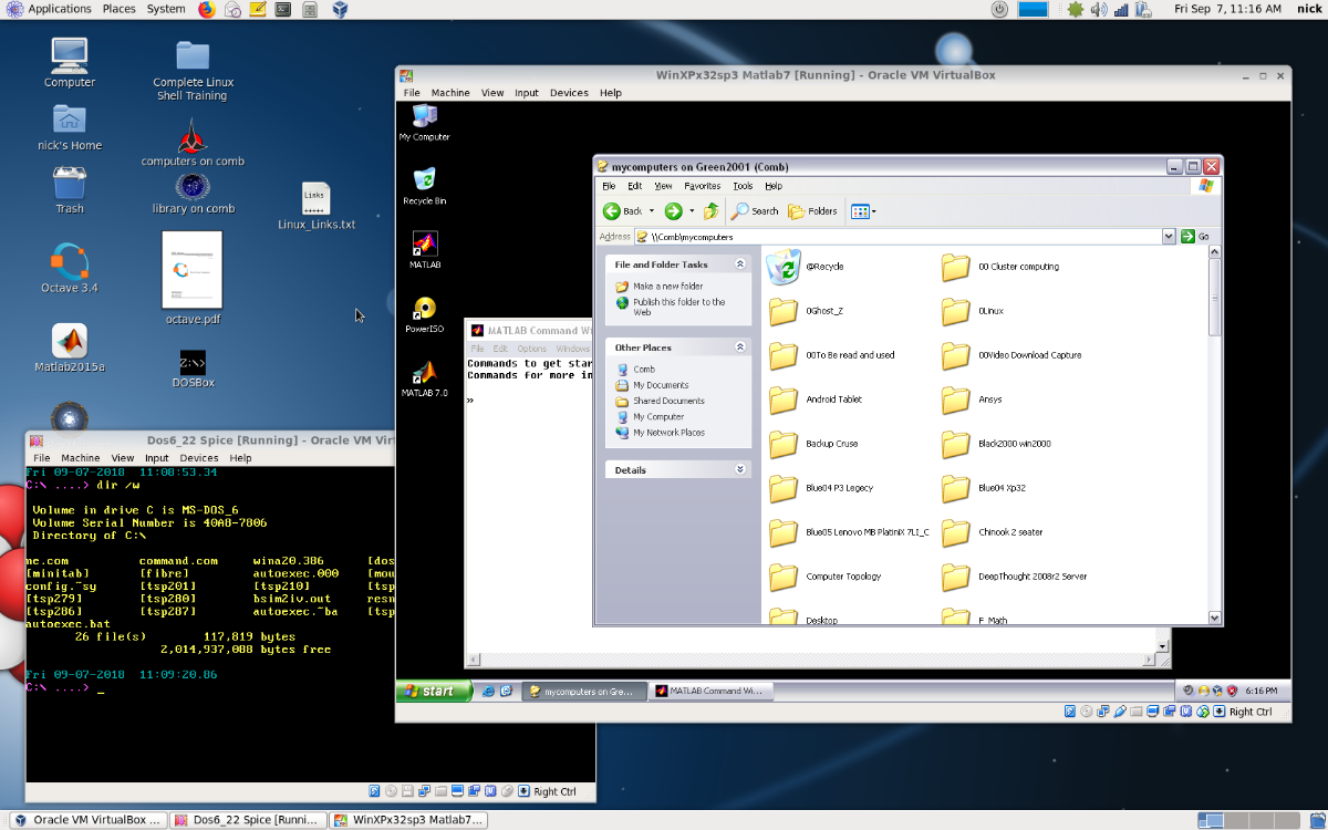

I have all of this running on a PC like running DOS6, this is also running on an Oracle VM in both Linux and Win10Pro.
However this exercise is to have the same software running on a SAMSUNG 21" tablet in DOS6 configuration with all of my old CSIRO software.
It is an exercise in revisiting my heyday by running DOS6 software including AutoCAD13 or 14 on my large Tablet without stretching 768 to 1080 and making it "block- pixel stretch". such screen stretching does not do my CAD work any favoures.
I know there is many many software CAD packages, but the aim is to stick to the original packages and software I designed.
I run a ground on my quest in only one package - AutoCad13 and 14 they do not have drv files for 1080 or 1050 or 1024 screen. ( note I have 768 DRV files )
