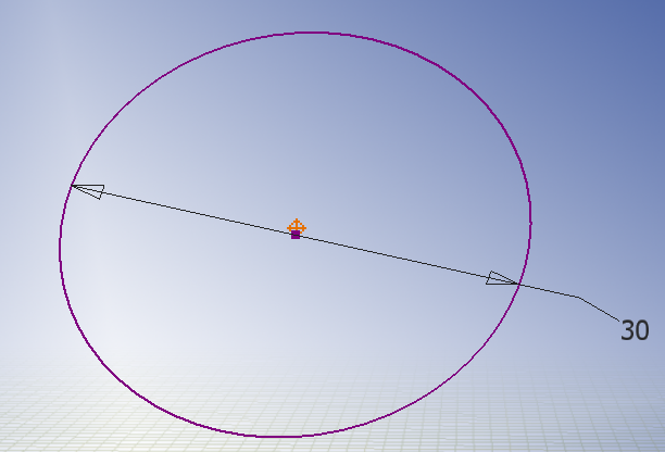

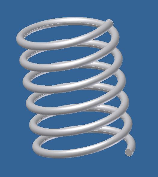

Rob123 Posted February 19, 2009 Posted February 19, 2009 i've got this problem with a coil, i need to make one for the machine im drawing, but i cant seem to get a coil in the right place. So ive decided to make an adaptive one, after looking at some tutorials i decided idd give it a try, it wouldnt work:( . I got the book and made 1 step by step, and it dint work:? !!! i cant seem to figure out what im doing wrong, am i retarded or is inventor just playing its trick on me here's a zip of what i got so far Veer.zip Quote

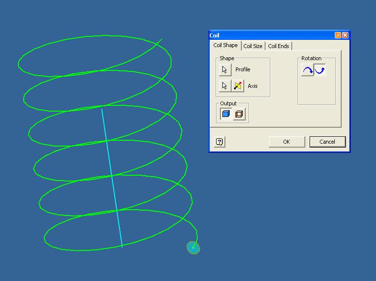

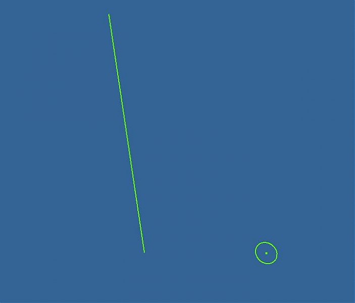

shift1313 Posted February 19, 2009 Posted February 19, 2009 sorry i cant open your zip because i only have inventor 11 at work. What is your coil producing? what is the profile you are selecting for it? you should draw the cross section of your coil and a direction vector. you can select x, y or z if you expand your origin folder in your model tree. Here are a few screen shots i just did in inv11 If you are trying to draw a coil, lets say between spring perches, draw your coil with a perpendicuar plane to your base perch and draw a 3d sketch line from your bottom perch to your top perch. You need to have unconsumed visible sketches for this. In the coil dialog box there are different options for length, twists, pitch, taper etc. Quote
Rob123 Posted February 19, 2009 Author Posted February 19, 2009 Yes its a round shape, anyawys ^^, the coil issnt the problem , i cant get it adaptive, ive done everything the book sais but it just doesnt work for me , here's a SS . Coil.zip Quote
Rob123 Posted February 19, 2009 Author Posted February 19, 2009 The adaptive coil will be used as a spring .. Quote

Rob123 Posted April 1, 2009 Author Posted April 1, 2009 ive got the problem solved by giving a parameter to the Pitch of the coil, incresing the paramater makes the coil (Spring) stretch. But i stil havent found any way of actually making an adaptive one .. maybe JD mather knows ? Quote

JD Mather Posted April 3, 2009 Posted April 3, 2009 I did zip and attach what i still have so far check the first post.... I noticed on your Veer2 part that the circle is close to the origin but not constrained to the origin. Have you gone through this document? http://home.pct.edu/~jmather/AU2007/MA105-1L%20Mather.pdf Also from the iProperties it doesn't appear that you are on Service Pack 1? Quote
Rob123 Posted April 8, 2009 Author Posted April 8, 2009 I noticed on your Veer2 part that the circle is close to the origin but not constrained to the origin. Have you gone through this document? http://home.pct.edu/~jmather/AU2007/MA105-1L%20Mather.pdf Also from the iProperties it doesn't appear that you are on Service Pack 1? do these things actually matter ??? but anyways:P i never constrain my things to my origen, never thought id would be like, usefull ^^, .. anyways, can u draw the same coil ( spring) as i did, and make it a working one ?? owh ^^, and ill start constraining to my origen from now on thanks Quote
