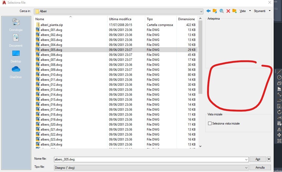

How do you preview these tree files without having to open them one by one?
How do you preview these tree files without having to open them one by one? Thank you

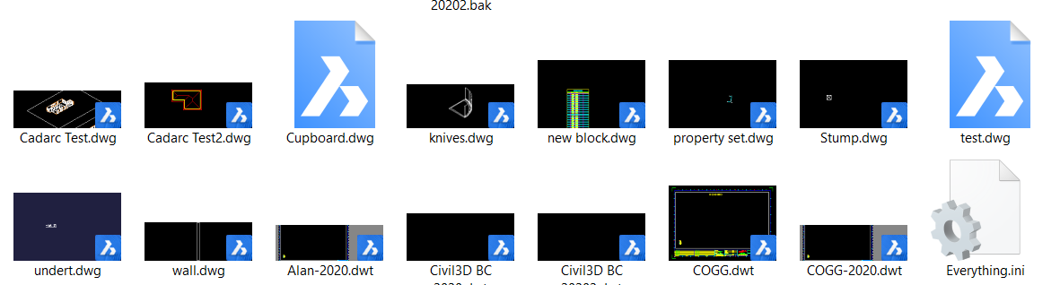

In explorer if you have view set to show icons it should show the dwg, which looks like what you want, ok a simple answer is if you write a script open the dwg, say zoom extents, then close and save, the bitmap image will be updated and should now appear.
I use some old fashioned DOS to make my scripts for this type of task. Have a look at scriptpro.

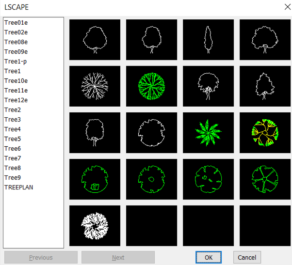

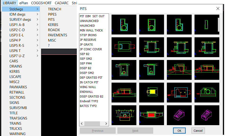

Or maybe this via a menu, if you can use notepad you can make these. Its part of a pop menu built in, note the More button if greater than 20.

From windows 10, I don't see the previews of autocad, instead yes for .pdf or doc, as you did? Thank you
