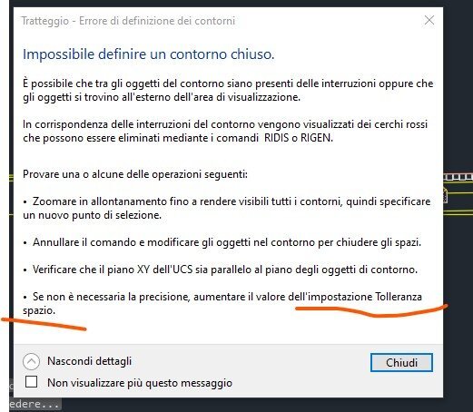

If when I'm hatching I get this warning, where do I find the variable Space tolerance setting to prevent the hatching from breaking, even if I checked all the closures between the lines? Thank you
When hatching big intricate shapes for years hatch has failed even though checking that shape is closed, a quick fix can be draw a line across shape and hatch say twice. The other may be use bpoly and create a new inside boundary, then hatch that, if it works you can select the boundary and erase.
