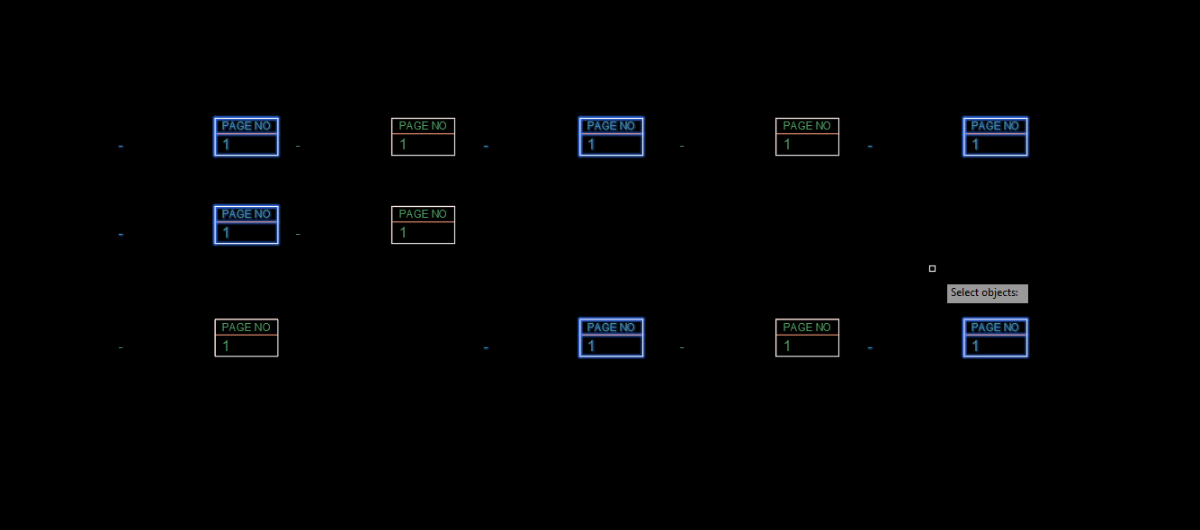

- In these pick selections, it gives numbers by following the selection order.       no problem with that
-   in select window selections    starting the numbering operation from the last entity selected     ( in select window selections   first selected entity > how to make first number  ?)

hi
fix selection window order   ,,
reversed in pick selections  ..
i.e. reversed the entire selection order  (((

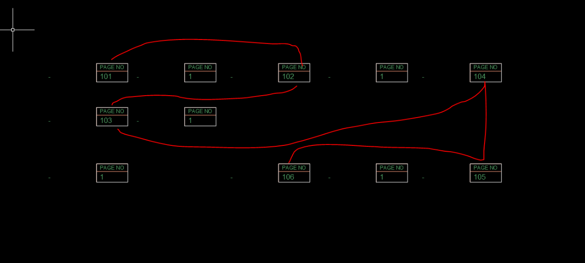

Ok select all then do a double sort on X&Y, you will say need to make a list ((x1 y1 entname)(x2 y2 entname2) .......   then sort it and then replace the attribute form a starting number.
Ps there is a subtle error in what I just posted will let you work it out.

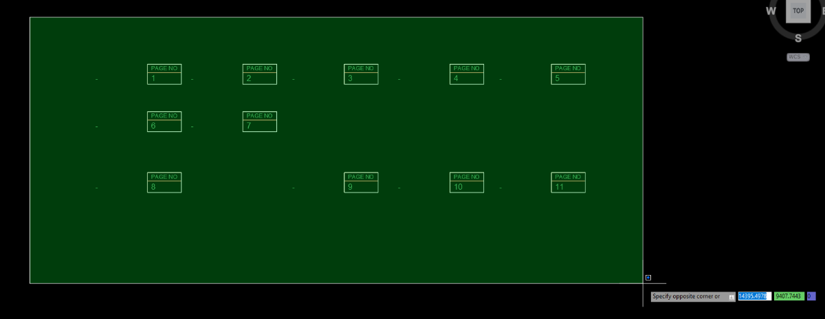

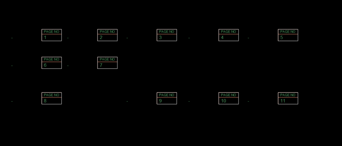

i want  ,
1-When I select one by one, it gives numbers according to the order of selection.  and
2-When I select with the selection window; starting to give from right to left and choosing the bottom row when the line ends
the code below; doing the first item.
but it starts the second item in reverse   (Starting from the lower right corner, it continues from right to left and up when the line ends.)
I will try , thanks
