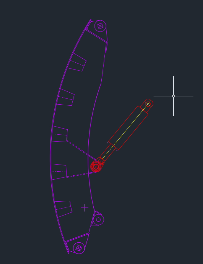

Please help me, i have this lisp ,
set all objects including blocks to color byblock and then set to color 200, except for dynamic blocks it only works the first time and then that's it, if i do setbylayer and then run this routine it doesn't work anymore on dynamic blocks.
The red cylinder is a dynamic block  which doesn't change back to color 200 after I run my lisp

This worked for me in BrisCAD.  tho i didn't have any dynamic blocks. so it might be treating them as nested or anonymous?

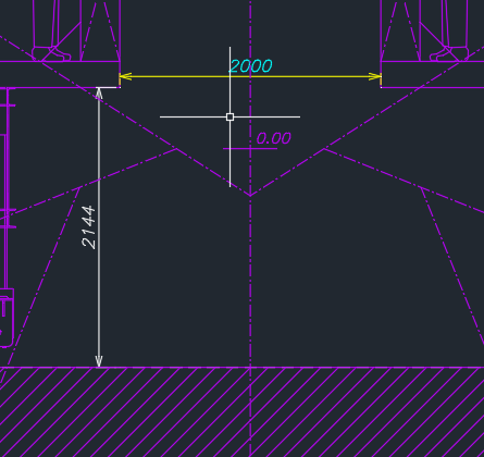

thanks in advance! it works but not for the dimensions...must not change the color of the dimensions
thanks but not work with dynamic blocks

your code is very fast than the other!  but it should keep the color of the dimensions and text outside the blocks...and could you also change the color of the groups to 142?

I mean all inside block must be' chance color to byblock ...and the block outside change to my color 200. The text and dimensioni outside blocks don't be changed.

THERE IS A NESTED BLOCK, NO anonymous
