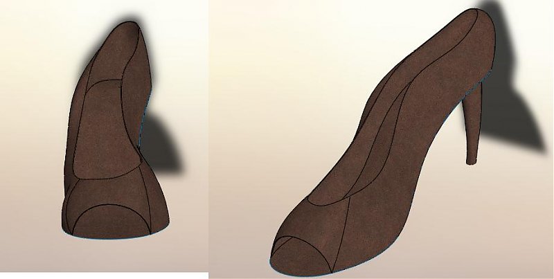

shift1313 Posted February 25, 2009 Posted February 25, 2009 i just did this in SW pretty quick(about 15-20mins). its a surface model but its a lofted surface(thickened). I used a curve for the opening of the shoe, a curve for the base or sole that went up over the toe area. the heel is a loft. i had maybe 10 or so guide curves going between the two loft sections. if i were to continue with the model i would keep modifiying these guide curves to produce the right shape(especially in the toe area. Quote

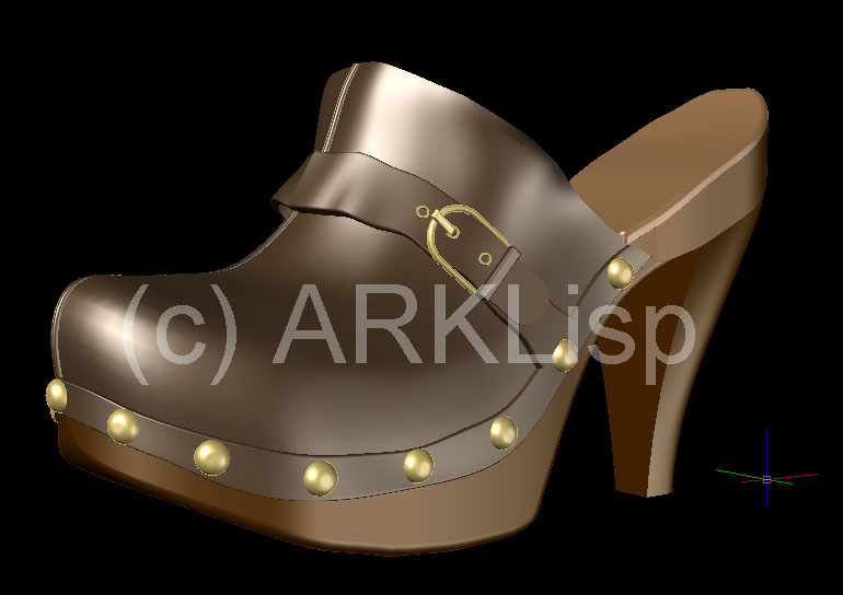

ARKLisp Posted June 1, 2011 Posted June 1, 2011 It's such a long time I didn't visit this forum. Many years ago I modelled this clog in Autocad (solids and surfaces). Quote
MRAKA Posted June 1, 2011 Author Posted June 1, 2011 Quality - Im gunna give this a go in AuotCAD as I aint got SW. Quote
ARKLisp Posted June 1, 2011 Posted June 1, 2011 The best way to model similar shoes in autocad is starting always from "blueprints" pictures. So, you can shape different 2d profiles (planar view, top view, left/right view) and through solid and surfacing operations you'll achieve that.... it's not certainly so simply to obtain this result... you have to work hard and accurately on it, but when you know the software and its limits you can do everything you want believe me! Quote
