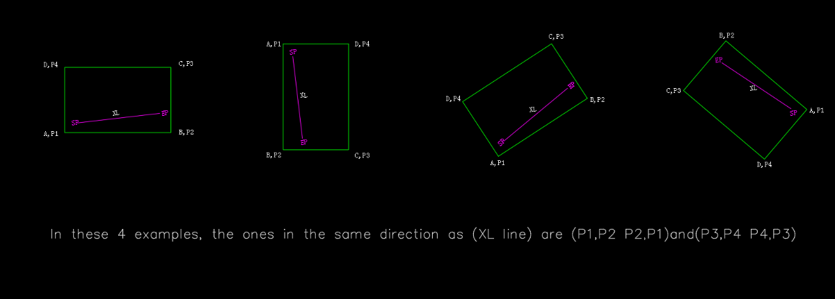

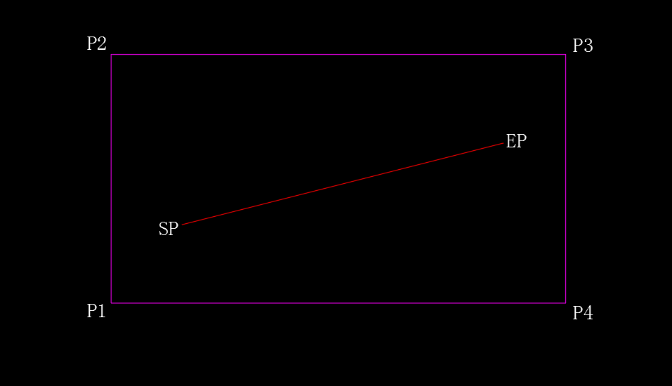

hello guys,Assuming that there is (setq lst( p1 p2 p3 p4)) in the point table, how to judge whether there is a point pair in the same direction as the SP-EP point in lst, and return a new point pair table if it exists. In the legend, p1-p4 It is consistent with the direction of p2-p3 and SP-EP
@ekko
As I can see , p1-p4 , is not consistent with p2-p3 , neither with SP-EP
Furthermore , WHAT do it mean CONSISTENT , for you in this case.?
Would it not mean ang1-ang2 < 90 (/pi 2.0) is a match.

There is something wrong with my expression. I mean that from the vector of P1-P4 and the vector of SP-EP, they are in the same direction. Even if they are not parallel, can you judge?
The logic you provided is correct. It's just about this legend. If you rotate 180 degrees in the graph, then it will be wrong to judge (* PI 0.5). Maybe you can adapt it by judging the angle. Mathematics is my weakness, which is difficult for me.
You can get the 2 angles then just think about the difference between them remember they are in radians. (/ pi 2.0) = 90 degrees.

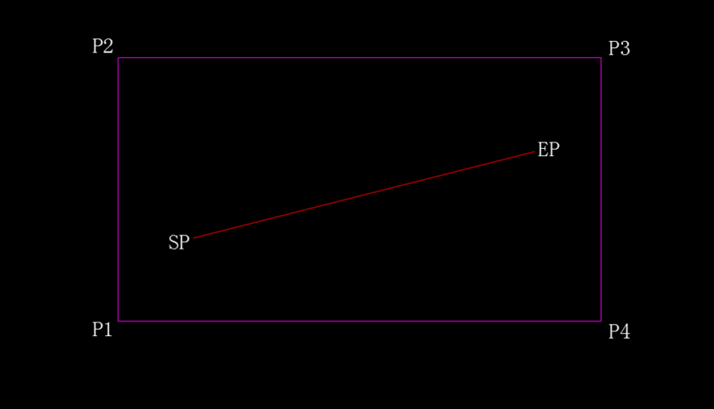

@devitg, @BIGAL  .I tried to write a piece of code, it is only for the first example, and the points must be selected in the order of p1,p2,p3,p4 in order to return the correct result. How can it be done, apply all examples, and get the correct result?
