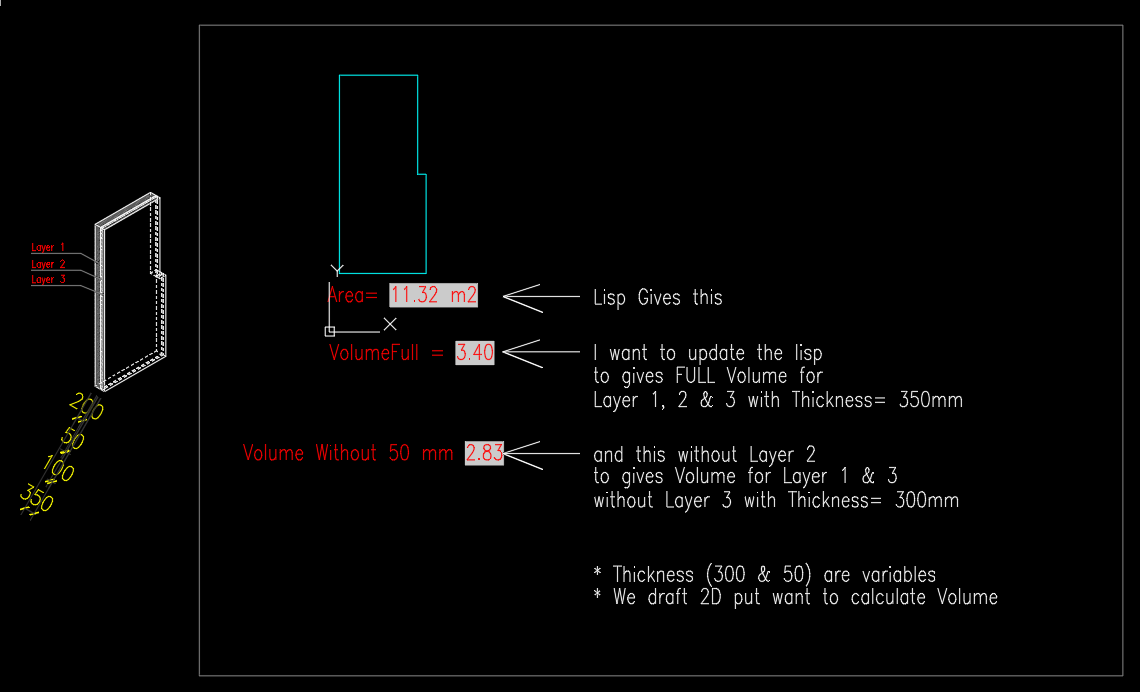

I have a lisp to calculate Area (this lisp for lee mac)
And I want to upgrade the field to calculate the volume.

16 hours ago, devitg said:
@asos2000 Please ulpoad your sample.dwg
We Are drafting Precast concrete sandwich panel.
Layer 1 & 3 are concrete and layer 2 is insulation.
So we calculate 2 volumes.
- Full volume  concrete + insulation Layer 1, 2  & 3
- Concrete only.Layer 1 & 3
Edited by asos2000
I understand what your doing but if you have say a sandwich construction  you need the Cyan pline to have extra properties you can not change shape and expect the volume to reflect the change. You are changing thickness so makes field calc redundant.
Are you confused and using wrong terminology in that you just want a text answer given a pline area and enter values of sandwich thickness involved that is easy. That is just get area of pline and multiply by a thickness.
Look at my true 3d image. Yes can get different material thickness and use in a MTEXT field.
You could use this 6 vertice shape in a Field but it would use only the preset thicknesses multipliers. eg 100  when you want 50.
Edited by BIGAL
I am sure that 3D makes it easier, but I can't create 3D for each panel.
I was trying to get use the lisp instead of using the calculator.
To make it easier I am thinking to make the volume to be calculated in field.
I'll try to make solve this issue without field.

Still think it would be easier when making the shapes to duplicate them at say different Z levels and with a thickness. Then can select all 3 and get say by layer the relevant thickness to be used in the field.
If you need a lisp to take a pline and copy it vertically changing layer and adding thickness can be done pretty easy. Put on layers set to no plot.

Interesting example Tsuky of using multiple field values, the only problem I see is referring to the comment by Asos2000 "We Are drafting Precast concrete sandwich panel." Well concrete tilt panels can vary in thickness so how do you relate the field to the correct thickness for that object ?  That is why I am pushing multiple objects or Xdata or LDATA or hidden block with attributes.
If you have to enter the thickness each time it defeats the automation, way better is draw the panel with the thickness attached. Tilt panels have been around for a long time, there is lisp code out there to draw them say starting with 10 basic shapes just enter values and the panel is drawn. Stuff like centroid and weight calculated. The simplest shape is a rectang so start with this.
