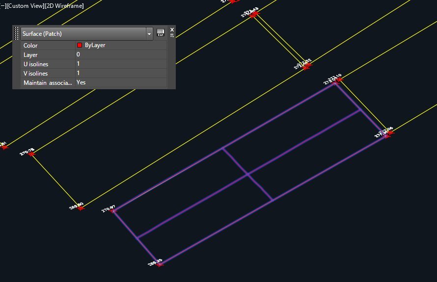

The 4 points of the 3D polylines are not in the same plane. I checked a few of them and they were all slightly twisted.
SURFPATCH will work to create a surface, but it won't create a 3D face. You can adjust the properties of the patch and set the U isolines to 1 and V isolines to 1. That will create a patch of 4 poly's, but that's the best you can get.

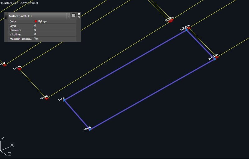

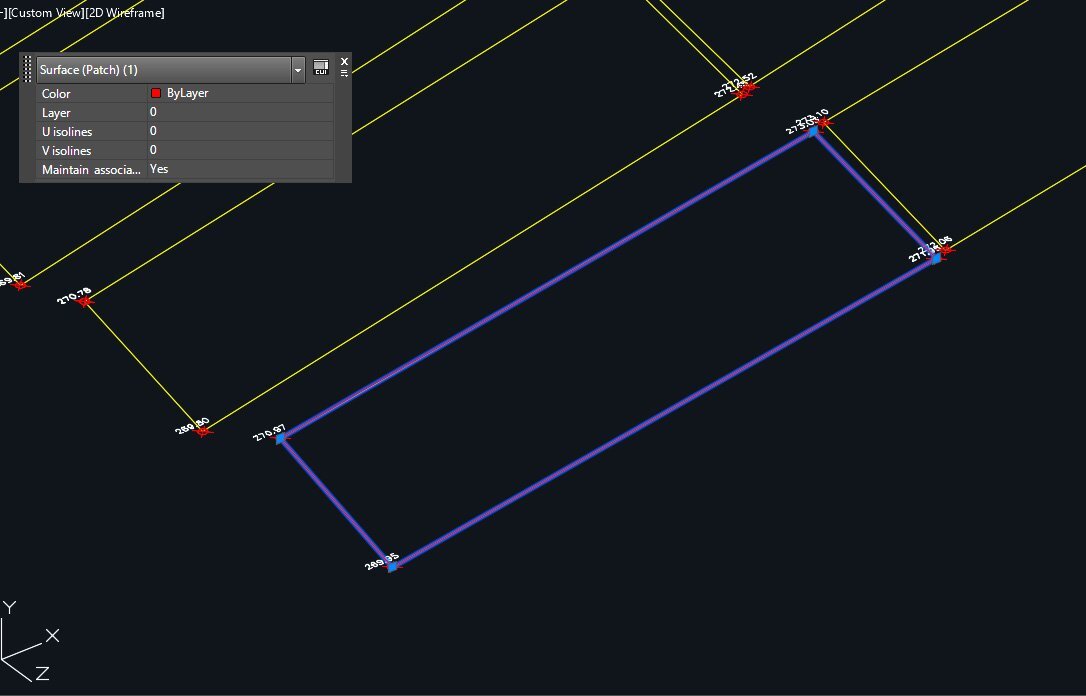

Actually, I was wrong. You can set the U isolines to 0 and the V isolines to 0 and that will create a single poly face.
Thanks to all.
