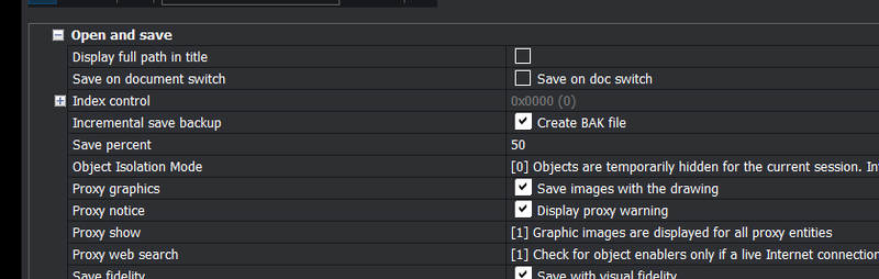

Start with looking in Options, Files, Temporary File location, in this location will be AC$ & SV$ files, also check save file path, you can see by date etc try renaming them to .dwg and open.
Make a copy of the BAK file and rename it to Coline.dwg and open may help.
Very unusual.
I have autosave set to say 15 minutes this will make the SV$ files. SAVETIME.
