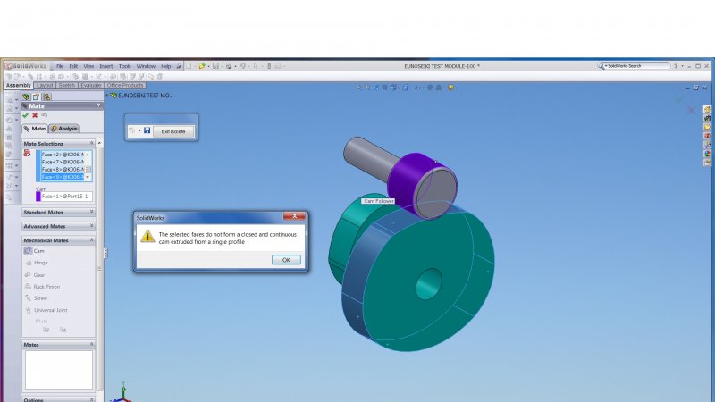

Hi, everyone.
I have a problem to use the cam mate? pls teach me how to use it.
my problem have attach with a photo.
Thanks
It looks like either you havent selected all the faces of your path OR you dont have tangency everywhere. When you are selecting the path just right click on one of the faces and "select tangency" and it should select all the faces. If it doesnt you may need to alter the part
