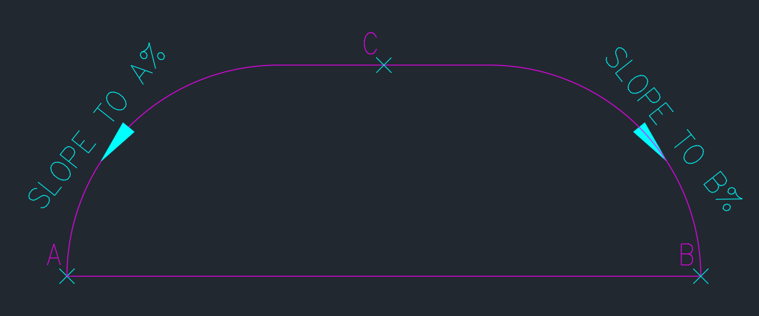

What I am looking for is to create a lisp that has a self adjusting attribute value.
This value would be based on a few factors. I think the best way to describe what I am looking for is to show an image and explain that way.
Point A & B would be given points (Elevation heights) and also fixed in place.
Slope to A & B could be anywhere between 2% to 5%.
Point C is the value I need returned along that curved polyline.
This much I can do. Its a bit tricky and probably needs some code updates, but I have it working.
What I am looking to add is something like this....
Give the user the option to LOCK a Slope at a percentage. [Lock Slope] Then [Lock Left Slope][Lock Right Slope][None]
Once a slope is locked, I would like the user to be able  to drag Point C to their desired location, with the number for Point C and the opposite slope being updated as point C is moved along the path.
I have seen Lee Mac's Object Align lisp and know about the vlax-Curve functions that can do the "Move Point C along that path, get the distance From point A to Point C along a curve etc etc. SO I can figure out how to do the math and get the numbers.

You can get the angle of a point along a pline, never tried in arcs.
Try this, not really tested.
(defun alg-ang (obj pnt)
  (angle '(0. 0. 0.)
     (vlax-curve-getfirstderiv
       obj
       (vlax-curve-getparamatpoint
         obj
         pnt
(setq obj (vlax-ename->vla-object (car  (entsel "Pick obj"))))
(setvar 'osmode 512) ; nearest for testing
(while (setq pt (getpoint "\npick point on pline"))
(princ (setq ang (alg-ang obj pt)))
