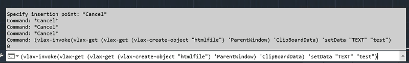

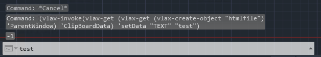

I am trying to store some data of the AutoCAD drawing into clipboard for other paste use using command/lisp.
(vlax-invoke(vlax-get (vlax-get (vlax-create-object "htmlfile") 'ParentWindow) 'ClipBoardData) 'setData "TEXT" "test")
When I run the command above, It is successful to store the data into clipboard when it run in Local Machine, and the administrator account in Virtual Machine, with code -1
However when I run the command under user account in Virtual Machine, it is fail with code 0
Any idea to solve? Thanks
