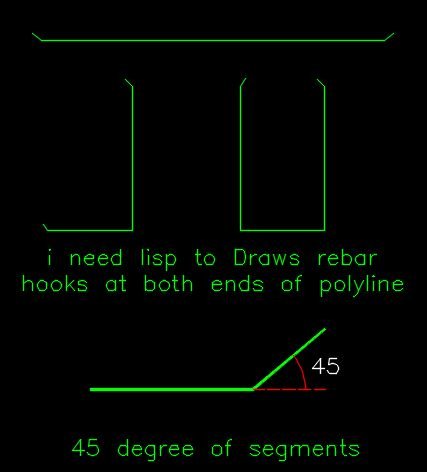

hello .
i am new at this forum
can you help me to write lisp  .
thanks for all worthily efforts
