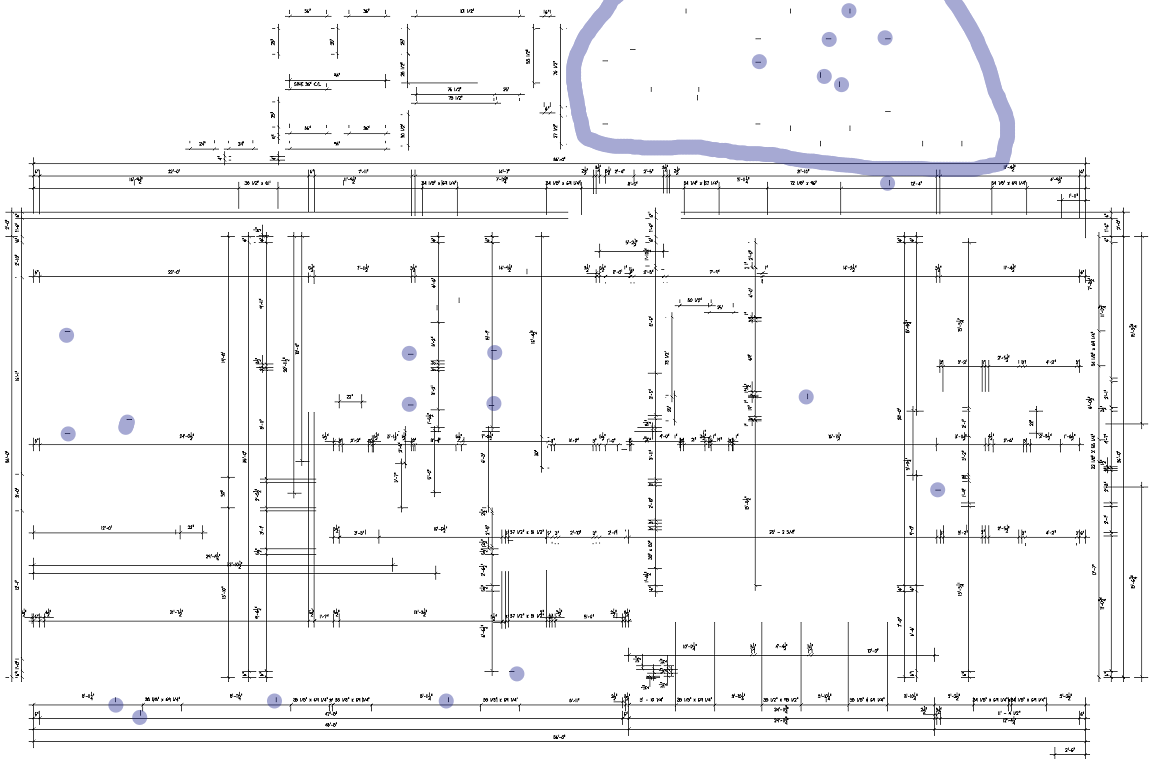

There doesn't seem to be any reason these little lines are showing up everywhere. Isolated it down to the dimensions and that layer. They are not on the plan. I've purged and audited...nothing. Tried exploding a couple of dim's to see if they became visible at least. No idea. Any help would be great and thanks in advance if you do.

Post your computer and graphics card specifications as well as the .dwg file.
They look like the 'arrows' at the end of the dimension lines or a part of the arrow. If they arn't meant to be dimensions there. Can you select them? I guess not because then you'd tell us what they are. Some look like they are in pairs, some don't (though not sire if this is only a part of the drawing). If they arn't in pairs, perhaps zero length dimensions but not sure why you can't select them. Does your drawing have any frozen or locked layers (if this is in a view port, check viewport settings too) - perhaps on a hidden and frozen layer these lines could be a part of a block or dimension that is on the dimension layer?
Yes, if you can post a drawing that would be handy.
