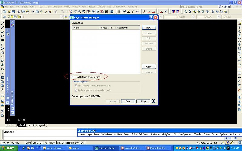

there is a 'tickbox' with 'don't list layer states in xref' written next to it. try unticking it & it will show you the layer states & you can restore them also. only drawback could be that when you apply that layer state all new layers in this drawing will switch off as well.
1. Where is this option. IS it available on 07?
2. You could group filter all the non-xref layers in a drawing without the xref prefix and turn them back on globally once the x-ref layer state has been applied. You could then save the new state!

Diapli,
I can't find the "tickbox" either so I can't experiment with your suggestion. If it is available on '07 and I can find it I'd love to test your solution.

posting a screen shot of layer state manager & highlighting the tickbox I was refering to earlier.
