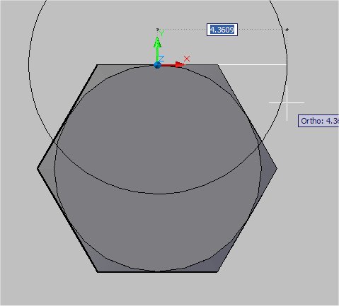

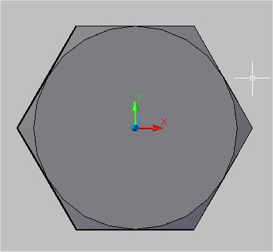

Here are two images. As you can see the UCS seems to have a mind of it's own. This is not what I was taught and ACAD 2007 which I'm using on this machine seems to be going bizerk. The first image is when I start out with the UCS at the center of the bolthead. But then when I try to draw a circle and the UCS jumps to a new location.
Why is the UCS moving around without me telling it to do so.
The "@" means "relative", tellin AC the next point is a certain distance from the previous point. Leave off the @ if you want point at coordinates of "10,0,2.9".
Newwer versions have a "dynmode" & "dynpicoords" settings (see "dyn" button at bottom) that allows leaving off the "@" depending on its setting.
Thanks dude, but if you carefully re-read the original post, the @ sign was not entered by me. ACAD did that. The prompt said Enter Next Point. I am assuming it means enter the next set of coordinates unless I enter the @ sign myself to tell it to move relative to the end of the last line. Sorry to be such a pain but again this is what I was taught how ACAD is supposed to construct a line. If I enter coordinates, it draws to that point. If I enter the @ sign it draws relative from the last point.
