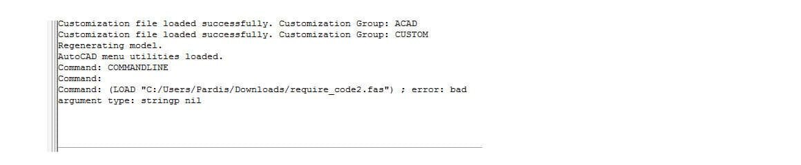

hard serial number error! w

whats the wrong with my code
my autocad version is 2007https://i.postimg.cc/SxLnJNZ7/photo-2023-12-26-22-55-39.jpg
works for me too... maybe add (vl-load-com) at start of routine or try higher AutoCad version?
you can try this
(vl-load-com)
(cond
  ((not (setq wmi (vlax-create-object "WbemScripting.SWbemLocator")))
   (alert "Unable to set wmi"))
  ((not (setq srv (vlax-invoke wmi 'connectserver nil nil nil nil nil nil nil nil)))
   (alert "Unable to set srv"))
  ((not (setq drv (vlax-invoke srv 'execquery "Select SerialNumber from Win32_DiskDrive")))
   (alert "unable to set drv"))
  (t
   (vlax-for item drv
     (vlax-for prop (vlax-get item 'Properties_)
       (if (eq "SERIALNUMBER" (strcase (vlax-get prop 'name)))
         (setq ser (vl-string-trim " " (vlax-get prop 'value)))
   (if drv (vlax-release-object drv))
   (if srv (vlax-release-object srv))
   (if wmi (vlax-release-object wmi))
   (alert (vl-princ-to-string ser))
Edited by rlx
Works for me too.
Maybe you can use vl-bt to find the problem by adding an error function.
(defun *error* (st)
  (vl-bt)
