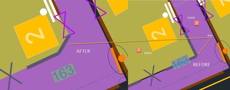

I'm working with a drawing from a traffic consultant.
In many of my scenarios, hatches on both sides should be governed by the same  polyline.
Thus, I want both hatch to follow when I need to make changes to the polyline.
How should I approach that the best? AutoCAD vertically, perhaps?

If a hatch is associative and you change a boundary object the hatch will follow, ok so a problem a partial boundary can not be used, but if you had a say layer off boundary with the extra vertice then the shape can be changed, but you have to move the 2 points, which can be done. So the original would need to add a vertice then change shape. Hopefully hatch changes, not tested.
If I had to edit two hatches on either side of a polyline, I would create boundaries for both hatches (if they didn't have them already) and make sure they're associative. I could then edit both of the polylines along the shared border at the same time.
how come both hatches or both poly can be associated?
You can only associate one hatch to one polyline. So to have two hatches next to each other, you need two polylines and two borders.
