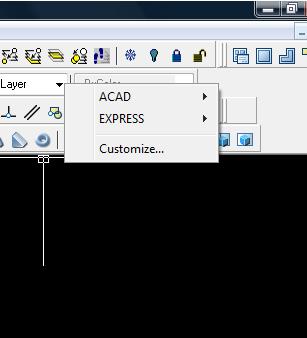

Ritch7 Posted March 3, 2009 Posted March 3, 2009 if you want to add a toolbar kaddy, right click anywhere on the outside boarder untill a tab comes comes up with stuff like ACAD EXPRESS .... ... depends what program you're running for the exact list, but the basics for autocad are in ACAD click then tick or un-tick the toolbars you want. Is this what you're after? or are you trying to customize a toolbar spefically, anyway if that dosen't help be sure to look at the bottom of the page to see the similiar threads. Note: Object-Snap is at the bottom left "0-SNAP" use F3 TO ENABLE/DISABLE IT?? Quote

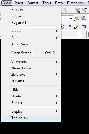

Lee Mac Posted March 3, 2009 Posted March 3, 2009 To enable a toolbar, either right-click anywhere on free space on the user interface and select the toolbar to enable. Or, alternatively, go to "View" "Toolbars". Quote
