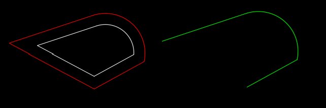

See the attached drawing where it offsets to the left side no matter what. How can I fix this?
Offsets to the left no matter what side.dwg
something is up with the lmac-offse funciton or im not understanding cuz its mapcar wrap in a function thats wrapped in a sort thats wrapped in a mapcar thats wrapped in a lambda thats wrapped in a funciton to say delete this line but its defaulting to witch ever is drawn first. it looks edited so maybe go and download it again?

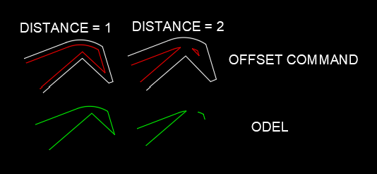

The program ODEL has a couple of glitches but I did not find inside vs outsideto to be one of them.
ODEL does seem to have a harder time dealing with edges that "disappear" for inside offset if the distance would nulify a line segment.  Red lines are the results of offset and green ODEL
ODEL does not handle polylines that are technically "open" but can be considered closed from the fact that their first and last vertices are coincidet. The red polyline is the result of OFFSET and the GREEN is create by ODEL.
