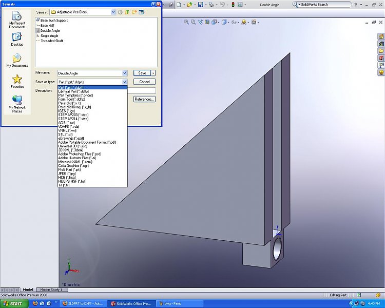

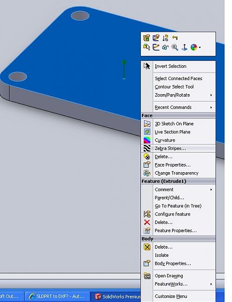

shift1313 Posted March 9, 2009 Author Posted March 9, 2009 this is what my save as type looks like. and tif is the last one on the list. Ive tried doing it in an assembly file and also in a part file but it didnt seem to matter. Also inside a sketch, after the sketch was complete but not a solid, after it was a solid. The second image is the menu i have after selecting a face and right clicking. Quote
Pounce Posted March 10, 2009 Posted March 10, 2009 It looks as though you're trying to save a solid as a .dxf. Create a drawing of the part, then save as a .dxf. Quote

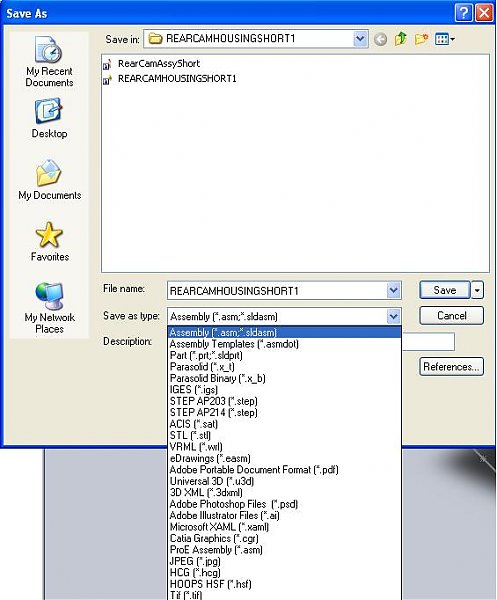

Pounce Posted March 10, 2009 Posted March 10, 2009 As you can see in the first pic, it's saved from a drawing and the option is there. The second pic is saved from a solid, and the option isn't there. Quote
shift1313 Posted March 10, 2009 Author Posted March 10, 2009 Ah, i see now:) I was under the impression that I could export as a dwg or dxf from a solid( i guess because flat pattern faces could be exported). I will give that a shot once my simulation finishes running. Thanks a million!! Quote

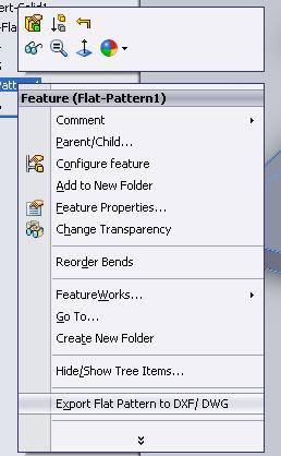

shift1313 Posted March 10, 2009 Author Posted March 10, 2009 well it works from a drawing file but i cant say that its exactly what I want but I can work with it. The drawing file requires a little extra work thats avoided in Inventor where i can just select a face of a solid part and export to dxf. The first file is from inventor with a solid part. second pic os from right clicking on the flat pattern in solidworks. I was hoping i could find something like that where I was able to select a face inside the drawing and export it. If this isnt possible then its not but it would be nice:) Quote
Pounce Posted March 11, 2009 Posted March 11, 2009 I see what you mean, it would be handy. What I like about the SW way, is once you have a dwg open, you can place a view of any piece in your comp on it, so you have multiple files on the one dwg, then you save it as a dxf for the cutting shop with everything on the one file. Quote
