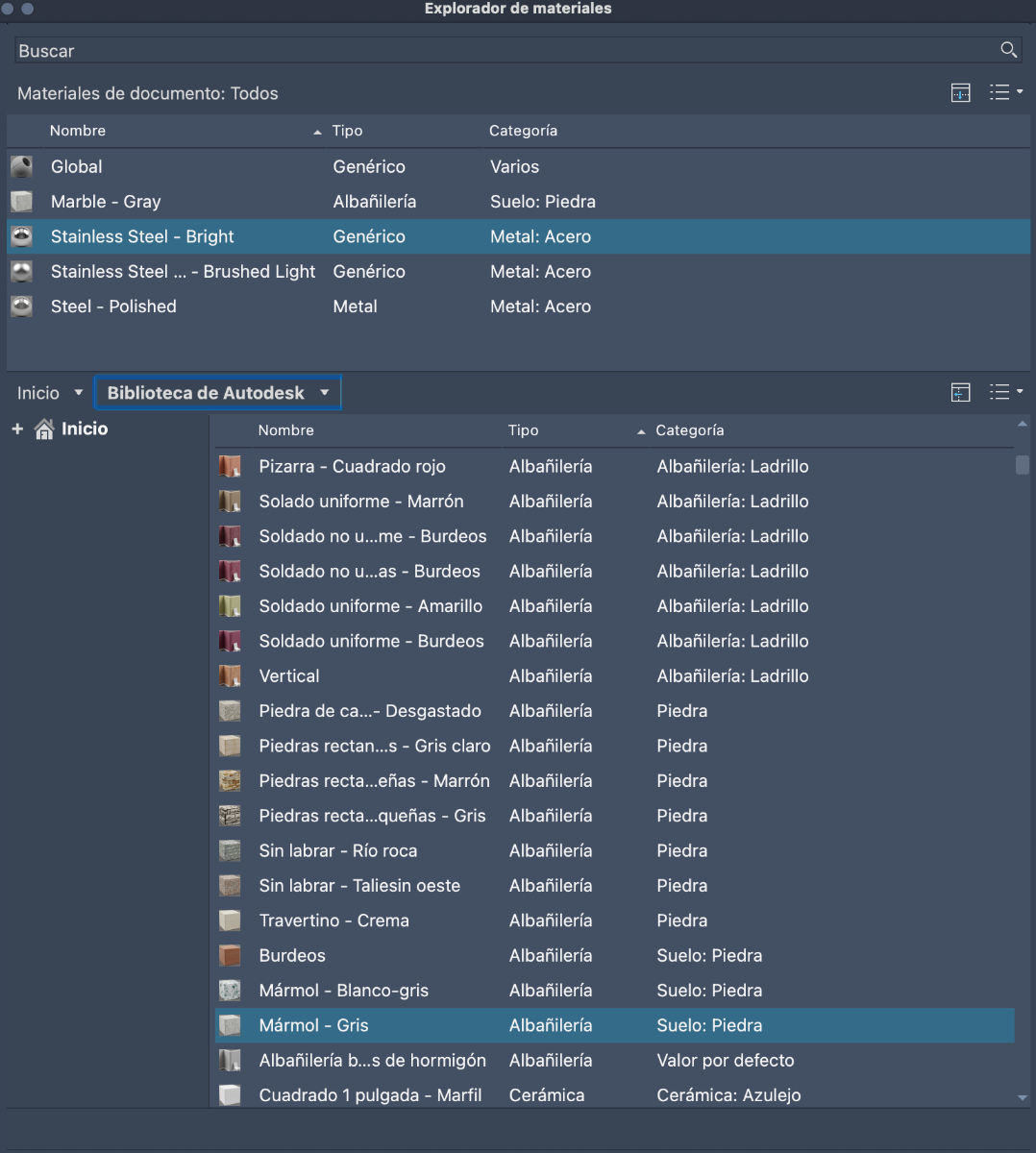

Thanks for your answer. But, I had already caught it a few hours ago, but not the window that appears in the documentation. How naturally can I locate that window? Do you know where the window is? Why do not you tell me? Materials show material list, not the window that appears in the documentation:
https://help.autodesk.com/view/ACD/2024/ENU/?guid=GUID-ED8BECBA-55D2-4B27-9046-616C23C6B0D0
I don't know how to access or get to what appears in the documentation.

If you double click on one of the materials, like the "Marble - Gray", it will open the window you're looking for.
You can also Right Click on one of the materials and choose "Edit" from the popup menu.

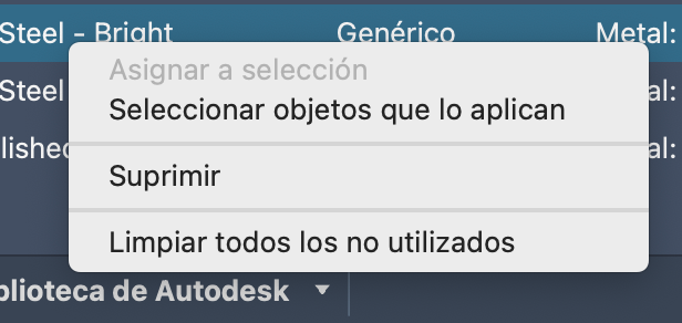

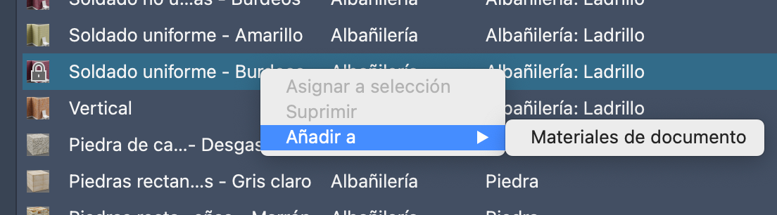

The double click or right click thing is the first thing I tried.
Double click: Tells me to select an object to place the material.
Right click: I get only one valid option "add material to current document".
It is the 30-day free trial, for MAC, version 2024. Will there be a window or section that I should open where I can explore? Maybe it's in a hidden window or panel, I don't know.

Ok, here's something you can try. I'm not sure if it will work on a Mac, but try using the MATEDITOROPEN command.
