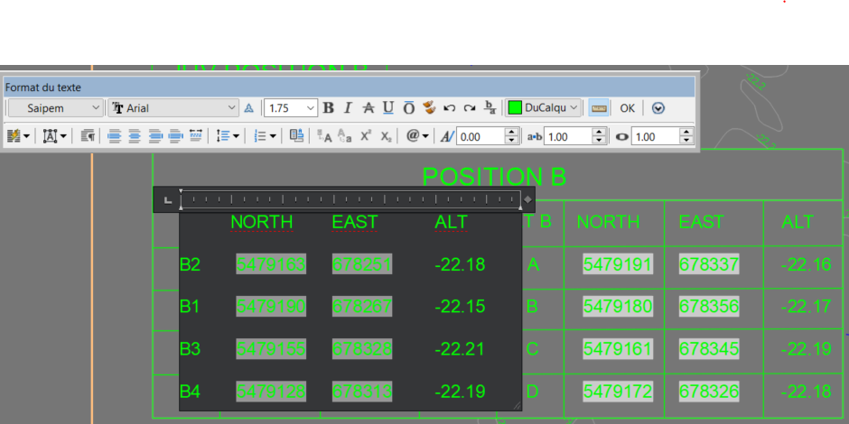

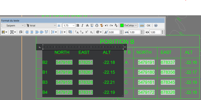

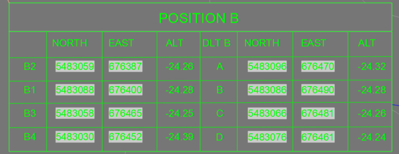

Fabs91 Posted April 16, 2024 Author Posted April 16, 2024 Hi Tsuky I agree with you, it works. I'm attaching a sketch to show you my Mtext, which has 8 fields inside. At the moment, I have to click 8 times for the MTEXT to update. thanks for your help. Fabs91 Quote
Tsuky Posted April 16, 2024 Posted April 16, 2024 Ok, You have multi lines or multi row/column in your Mtext. Try this (defun c:foo ( / ss n ent obj old new) (defun string-subst (nam_obj / value_string nbs tmp_nbs) (setq value_string (vla-fieldcode nam_obj) nbs 0) (while nbs (if (setq nbs (vl-string-search "%pr0" value_string (setq tmp_nbs nbs))) (setq value_string (vl-string-subst "%pr2" "%pr0" value_string tmp_nbs) nbs (1+ nbs) ) ) ) (vlax-put nam_obj 'TextString value_string) ) (setq ss (ssget '((0 . "MTEXT")))) (cond (ss (repeat (setq n (sslength ss)) (setq ent (ssname ss (setq n (1- n))) obj (vlax-ename->vla-object ent) ) (string-subst obj) ) ) ) (prin1) ) 1 Quote
