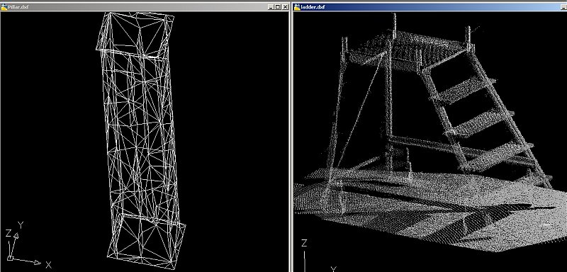

a.tec Posted March 11, 2009 Author Posted March 11, 2009 Zipfile: home.arcor.de/h3d/dxf.zip contains ladder.dxf // the pointcloud which inly shows up in the paperview Pillar.dxf // a scan of a pillar converted into a surface, which also does not show up, atleast it is selectable like a picture in AC. Thanks in advance for your help. Kind regards Artur Quote
shift1313 Posted March 11, 2009 Posted March 11, 2009 your second file pillar.dxf comes in as 3dfaces so this is something usable. The first file that is the raw point cloud data I do not believe is going to be usable for you. Quote
JD Mather Posted March 12, 2009 Posted March 12, 2009 ...which also does not show up Both files open fine for me. The point cloud is a long way from the origin relative to the size of the scan. Quote

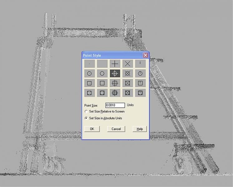

eldon Posted March 16, 2009 Posted March 16, 2009 Do not set the point style to dots, because they remain dots, no matter how big you set the size%. Set them to something else, then set the size to 0.001 absolute units. Then do a Zoom Extents, and you should see something. Then play about with the views. This is a 3D Front view. Quote
shift1313 Posted March 16, 2009 Posted March 16, 2009 i see the pointcloud in both model and layout space. to change the point style as eldon said you can go to your format menu and the heading point style should be there. Or you can type "ddptype" into the command line and the menu will pop up. What are your plans for this? Im not sure what changing the point style will do for you model wise. I was able to see it in layout view without changing the point style(or i should say no matter how i changed the point styles). If you need to make a model from this you will be better off using a software that can handle the point cloud and convert it to a surface/solid and then export it. If you just need to see it im not really sure what benefit you have in getting a point cloud model to start with. Quote
