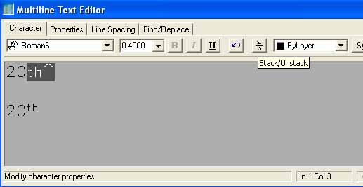

How can I place super script text into MTEXT?
ie To make the Date Look look Like 20th with the th part above the 20!!
Hope this makes sense!!
Cheers
Si
After the "th" put a carat ^ (shift 6), then highlight the th and ^, and hit stack/unstack

Just a fun fact, if you put the ^ (shift 6) in front of the text you sub script it.:D
