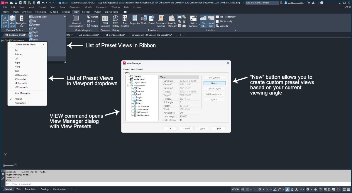

SLW210 Posted April 25, 2024 Posted April 25, 2024 You use VIEW command, View Manager dialog box opens, Preset Views (you can use the Ribbon to open View Manager as well). There is also a toolbar, View. I use: Top left of Modelspace and a Viewport, [-][Top][2D Wireframe], click on Top (or whatever is there at the time) for a dropdown for other views. Click on the - and 2D Wireframe for options as well. For not preset views I use Orbit, sometimes the Cube. I often consider writing some code to use the numpad like some 3D programs. Quote

Cad64 Posted April 30, 2024 Posted April 30, 2024 On 4/25/2024 at 12:28 PM, Emboss 2014 said: when i draw on model space for 3D modeling, i have a hard time understanding which side of plane that i am working on? Do you use the view cube on top right or USC coordinate to indicate the plane? sorry i am begginer in 3D autocad. Thanks As mentioned previously, there are several ways to select preset views or even create your own view presets. Quote
