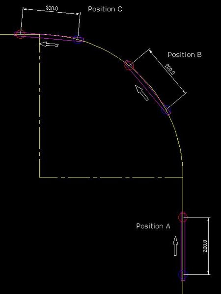

Someone please put me out of my misery! I have been fighting with this for the two days.
I am writing a program to do the following:
1.) Select a block
2.) Pick (2) location points
3.) Select a path
4.) Give a stepping distance
After this information is given I would like the program to step the block along a given path at the stepping distance.
I gave figured everything out with one exception. How do I calculate the transition between a straight line and an arc? My brain just put the formula down in the code. I know it is possible.
I’ve attached an image to help clarify. Position 3 is the area in question.
Thank you in advance,
Brian

what are location points? those marked with red and blue? if so, "measure" command won't do exactly what you need.
look into the vlax-curve functions, that will give you what you need

That’s very difficult in general cases. But if you limit it in some specific conditions (form and dimensions of curve), I think we can solve it.
Could you post your drawing file with full elements (curve and block)?
The red and blue points must stay in contact with the path at all times. They represent trolleys on a conveyor and are a fixed distance apart. (200.0mm)

I believe trying to calculate the point through a transition would be a a nightmare. And what iff line isn't tangent to the arc, or path is a spline, or....
So I propose using a method similar to doing it manually. That would be to draw a circle at the front of the trolley, R=200, and where it intersects the tracks is the back of the trolley. The routine would place a circle, determine the 2 intersections of the track with the function "vla-intersectwith". This will give you one or 2 points of intersection. If 2 points, find the one neast the beginning along the curve (one of the vlax-curve functions).
try it with "Path.dwg"
takes block insertion point as "location point 1"
it's rather slow, a little bit inaccurate (depends on Fuzz varible), no error catching
I agree with CarlB. That isn't expert method but give exact results.

I think I have done what you want using the intersection of a circle to find the two points it works currently on polylines.
