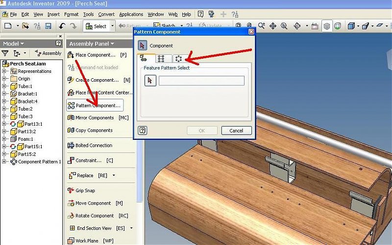

var Posted March 11, 2009 Posted March 11, 2009 Hi. I have a part inside an assembly that I want to flip around exactly 180°. If I use the manual "Rotate Component" tool I can't tell if I'm rotating the part exactly 180°. Is there any way to rotate components precisely with Inventor 2008 without using constraints? (the constraints are giving me other problems...) Thanks! Quote
Lazer Posted March 11, 2009 Posted March 11, 2009 You can use the pattern component to rotate 180 degree or any angle you like, have alook and let us know how you get on. Quote
JD Mather Posted March 11, 2009 Posted March 11, 2009 ... without using constraints? (the constraints are giving me other problems) Learn to use Assembly Constraints. Easy to use and follow logic of real world assembly. Quote
Rob123 Posted March 12, 2009 Posted March 12, 2009 or just constrain it the way you want it to be, then delete the constrains Quote

var Posted March 12, 2009 Author Posted March 12, 2009 The assembly (and then animation) that I have to make involves a series of door panels that hang from a track. The door panels start out in the same plane, but as they roll down the track they have to turn a corner (and the track splits into two tracks) and then the doors end up stacking up face to face (it's hard to explain). It's crucial that the rollers that the doors hang from operate properly so that they can roll and then turn the corner properly. The doors also have to be hinged correctly so that they can fold and stack. One of the more simple things that I'm trying to do is apply an Insert Constraint to get the rollers properly constrained around the the shaft so that they can actually roll. Then I need to be able to off-set the roller from the end of the shaft because they're not supposed to be flush with each other. Every time I try to do this I can either do the Insert Constraint or the Flush (with an off-set) Constraint, but not both. It keeps telling me that there's a conflict and I don't understand what could possibly be conflicting! Quote
shift1313 Posted March 12, 2009 Posted March 12, 2009 it depends on what you select, if you select a face or point or curve it all has different implications. It sounds to me that its a very difficult assembly to constrain with little/no experience in the matter. How long do you have to do this? is it possible for you to post a drawing of the track for someone to take a look at? Quote
JD Mather Posted March 12, 2009 Posted March 12, 2009 Every time I try to do this I can either do the Insert Constraint or the Flush (with an off-set) Constraint, but not both. It keeps telling me that there's a conflict and I don't understand what could possibly be conflicting! You can add an offset distance in the Insert constraint. You do not need the Flush constraint. I would recommend getting far more experience before tackling the job you describe. I find that most people don't have a clue how to model single parts, let alone do a job like you describe. Have you gone through these http://home.pct.edu/~jmather/AU2006/MA13-3%20Mather.pdf http://home.pct.edu/~jmather/AU2007/MA105-1L%20Mather.pdf Certainly if you are having trouble with assembly constraints you have a long way to go. Keep asking questions and attach datasets when appropriate. Quote
