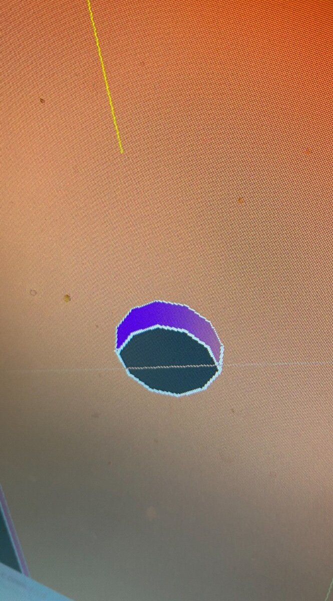

Emboss 2014 Posted April 29 Share Posted April 29 At first I was able to check the length and height of my Angle Iron shape that were inserted from AutoCad blocks. But now Properties window didn’t show the steel length or depth info. What happened? I added bolted holes using cylinder command and construction lines on the angle irons. Just curious how to get objects properties info to show all information. Thanks. Quote Link to comment Share on other sites More sharing options...

Emboss 2014 Posted April 30 Author Share Posted April 30 I apologized on the post. That is good to know. Be able to manipulate from property window is so helpful. I could not edit location of the slot hole from the property window now. Is there a way I can undo the holes or fill the holes and redo in the correct locations? Without redraw ? Thanks Quote Link to comment Share on other sites More sharing options...
SLW210 Posted April 30 Share Posted April 30 Get familiar with the Solidedit tools, in particular for this, move faces, offset faces, delete faces, etc. Quote Link to comment Share on other sites More sharing options...
SLW210 Posted April 30 Share Posted April 30 This is 2024, please tell me you are not taking pictures of your screen and posting them instead of using a screen capture or even better actually posting a file. Quote Link to comment Share on other sites More sharing options...
